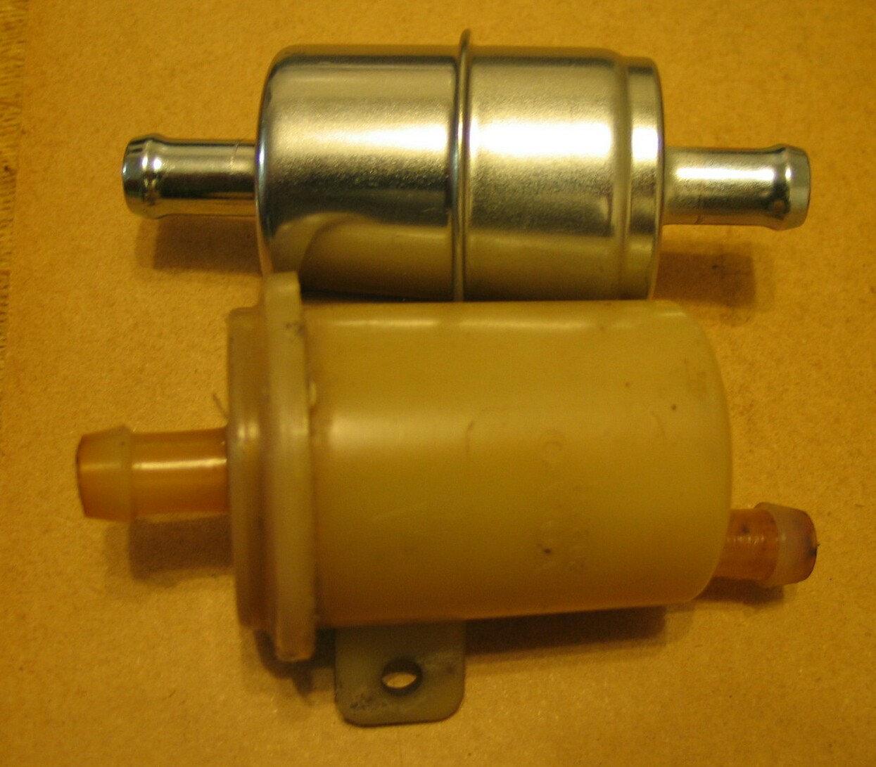

This is the filter by the fuel tank outlet. Anyone got a source for this, I've been through everything I can find online and its all too big (long) or too small unions. 12mm unions and a high flow rate are required.
Cheapest is a 200mm long unit from AFS, but no way will it fit. Next best is powermax billet type thing at £30, but still too big. I did try a Sytec unit but it had only 5mm holes inside and would have been too big anyway. There is a cheap AL unit from China but the could not answer any technical questions, probably too big anyway.
If I could get a right angle union I might be able to make the Powermax to fit.
There are some LPG filter that look good but hard to know if the are compatible with petrol and if the flow rate is high enough.

Had a quick look for Audi stuff but only the big pressure one came up. There isn't alot of space on the 360, the original is <110mm and the pipes bent at min radius, most of the standard parts are over 125mm and I don't think will fit.

Also looking at my original, still useable but a big pile of well stuck in dirt in it.

Thats the pressure filter, its too big and probably too restrictive for the pre-pump application.

So I got the Baldwin BF7693 and its a fairly good fit. It doesn't have the offset of the original so gets a bit closer to the tank, but I think I didn't use a long enough bit of pipe to the tank, so position is a bit critical. In the end I used a stuck foam pad to cushion it against the tank.
