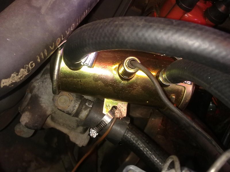

Thank you for that. I tried a new fuel filter and tested two new fuel pumps but still no luck. I then tested it with an electric fuel pump which I meant to fit to another car a couple of years ago and it started first time and ran perfectly. So I have decided to switch over to an electric fuel pump. You will be staggered by how impressive my technical skills at fitting this to the PS pipes are.... chuckle ;-0
The pump makes a pretty rapid ticker - ticker - ticker - ticker sound which I am not used to. The only other car I know which has a leccy fuel pump is a Morris Minor and what happens is the pump goes fast to start with and then slows down when the carb is full. That is not a re-circulating system, unlike the 340/360 which is, so I guess that is why the pump is ticking over so fast. Someone I know said it was OK if it runs pretty fast but I am still a bit nervous. Please let me know if it is a problem for the pump i.e. will it wear out too quickly and is there a way to slow it down reliably. Maybe a rheostat or something. Still lots of fiddling about to fit the wiring but the fuel system basically works with the new pump and a bit of plumber's PTFE tape has even stopped it leaking

It will tick fast constantly being a recirculating electric pump, if it gets really loud then it is running out of fuel. What pressure is it running though? It will want to be around 3psi.

Yo! It works. I found a free connector on the end of an ignition-controlled black and white wire which is just next to the fuse box and wired the new pump to this. It all seems awesome. I tried a couple of rheostats to lower the pump speed but they both sparked and smoked, so I quickly gave up on that idea!! The pump will just have to jiggle away to its own ticker-ticker-ticker sound which you cannot really hear from the passenger compartment so it should not be too embarassing for the driver.
