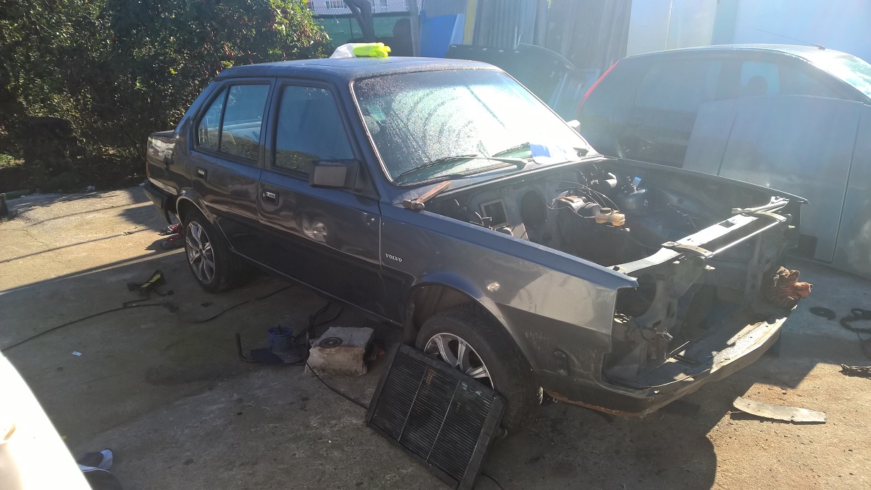

the car...bought for 190€ plus 25€ towing fee and sold the engine for 125€ - current cost 90€

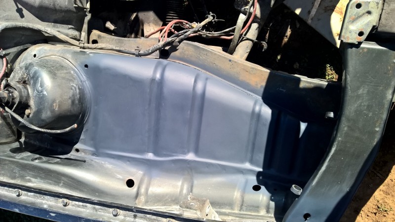

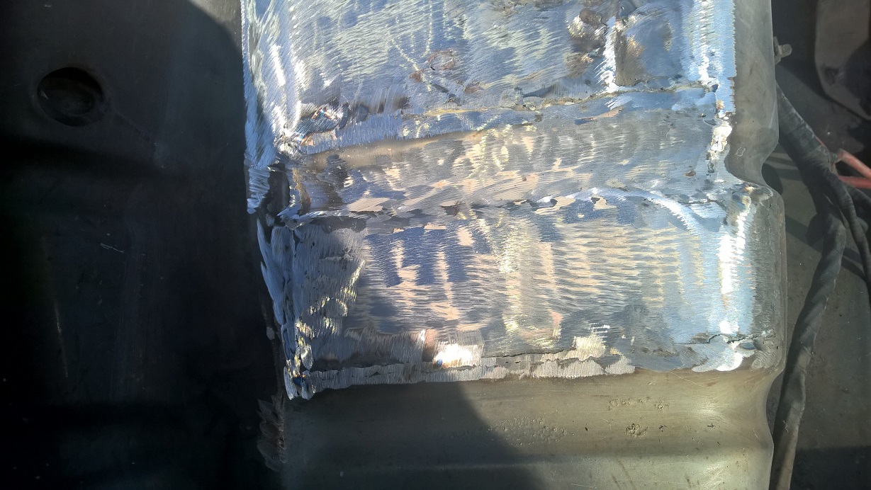

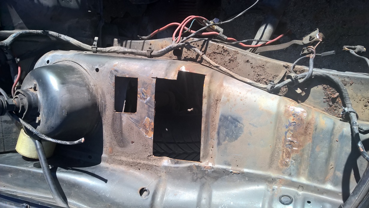

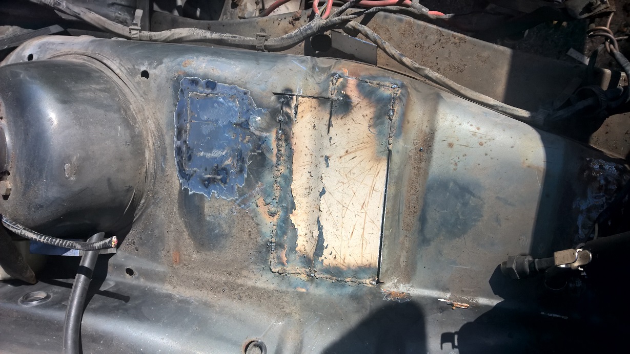

first job was patching rust holes...it was my first time mig welding , only knew how to weld stick

That looks like a brilliant project and some decent welding.
Good luck, hope it all goes well.

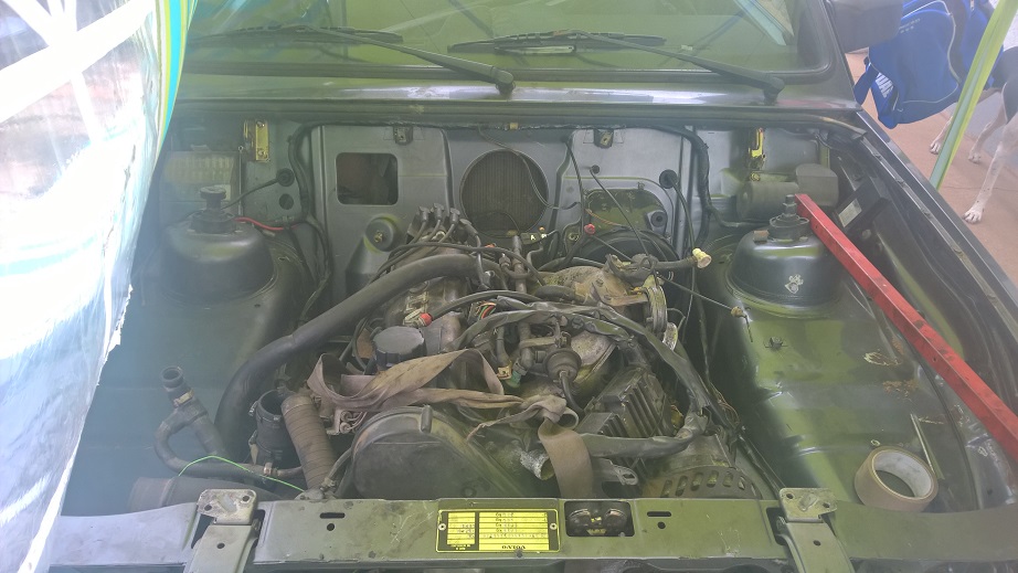

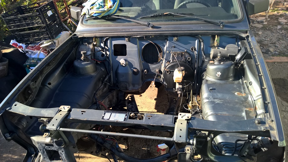

yesterday i was bored and pressure washed the engine bay because it was filthy and now it makes me more motivated to work on it

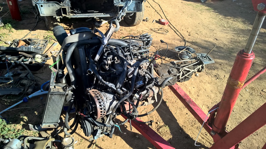

this is the donor 740 wich is also mega-filthy but runs good
the weird propane hoses are for a temporary fuel tank and pump i installed to test the engine because the original was rotten and the pump seized this is a mitsubishi colt fuel tank as temporary tank to power the 740, pressure is 3 bars
later i will use the pump assembly and internal swirl pot and fit it into the 340 tank along with a walbro pump the loom i trimmed to the essentials and tested the engine if still runs
now with a schematic i have i will redo it entirely with the old one by my side and the schematic to stop me from making mistakes
engine is out and its filthy
has a leak on the oil pressure switch and on the turbo return line
it leaks gasoline into the oil so maybe a clogged injector or the cold start injector seized open now i have good and bad news
good news is the rear axle from the 740 is almost the lenght of the 340 so it will fit,although i have to redrill it to 4x100 on a machine shop. i will use the rear disk brakes also
bad news is gearbox wont fit the 340 tunnel..i will try to bash it but i will probably have to strip the interior to widen the tunnel

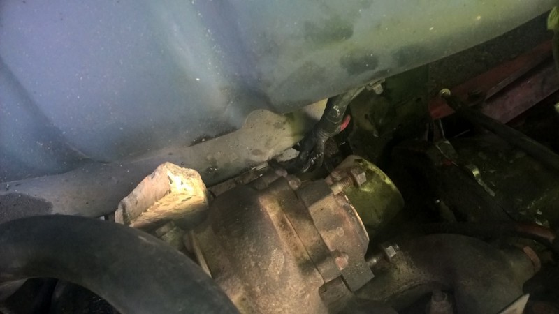

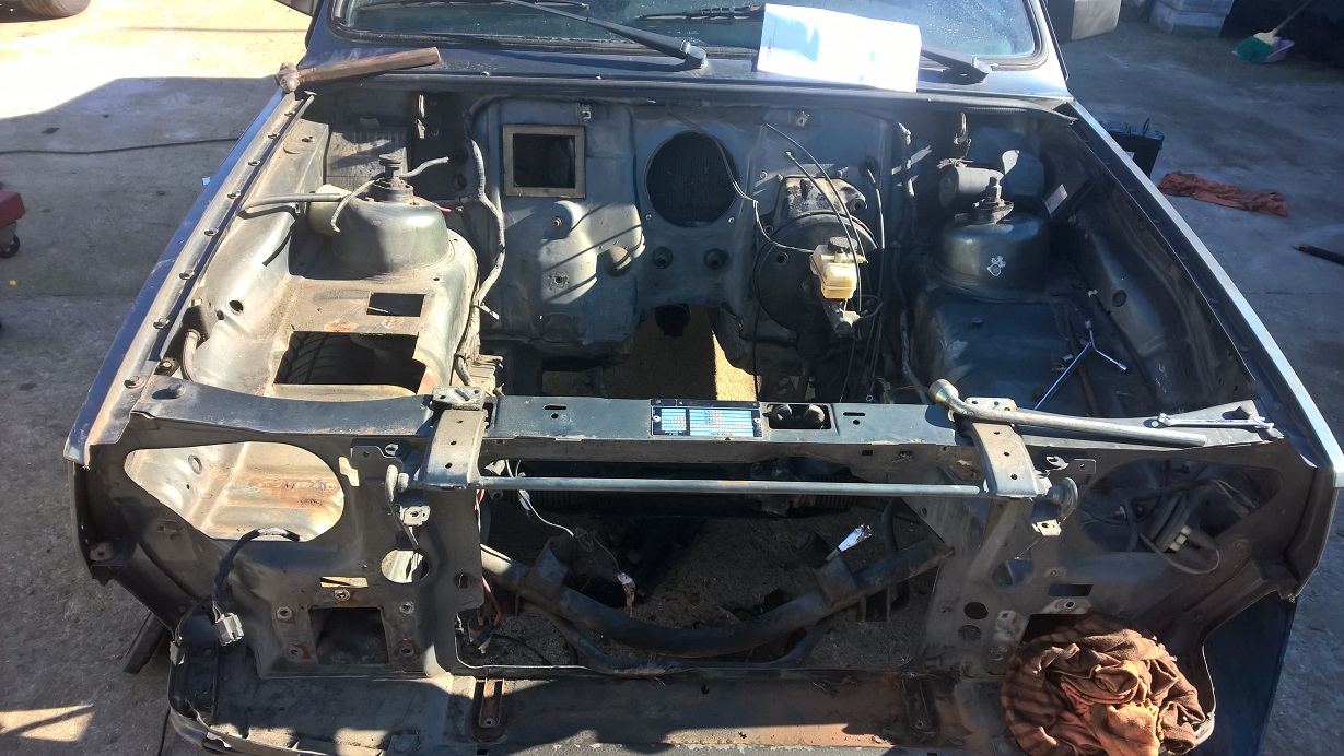

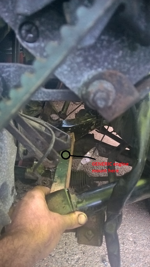

engine is mocked in place with some blocks of wood
front clearance looks like this
the mechanical fan will go to the junk clearance from the turbo to the chassis rail
looks ok to me steering rack is unbolted because it fouls the bracket of the clutch cylinder for the mounts i will weld this piece of tube like this and insert a generic engine mount, those cylindrical with a threaded rod on each end please any ideas are welcome before i screw up further

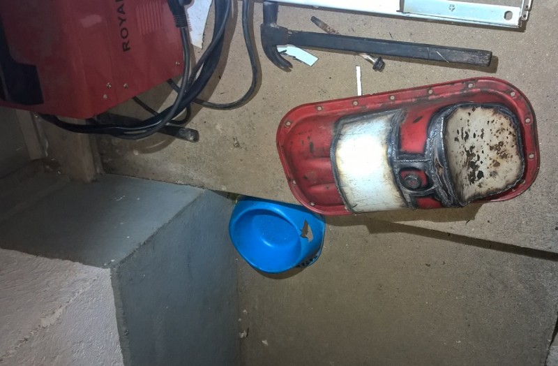

well today is sunday so in a 4 hours spare time i started doing the sump
it now clears the steering rack by 2cm all around
i still have to weld it on the inside,weld some baffles, tidy up the outside and make a dipstick tube so another 4 or 5 hours of work
it looks strange shaped because of the oil pump wich requires the side bulge....but it will be under the car so who cares
the metal was from an old washing machine
but the thickness is about the same as the sumps metal...it was a sturdy washer
