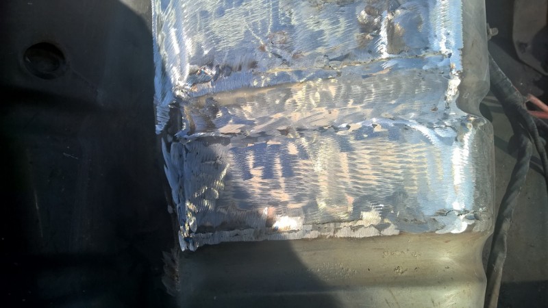

well today is sunday so in a 4 hours spare time i started doing the sump
it now clears the steering rack by 2cm all around
i still have to weld it on the inside,weld some baffles, tidy up the outside and make a dipstick tube so another 4 or 5 hours of work :shock:
it looks strange shaped because of the oil pump wich requires the side bulge....but it will be under the car so who cares
the metal was from an old washing machine :lol: but the thickness is about the same as the sumps metal...it was a sturdy washer
