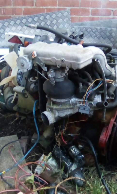

Post by bolstermonobloc » 28 Jan 2019 11:35 am
Like this one?
Posts: 5465
Re: 480/340 engine swap
Post by classicswede » 01 Feb 2019 09:59 pm
No that is a B200E or B230E from a 240
The B20F was found in 440/460/480 models. Looks exactly like a 340 1.7 from the outside
