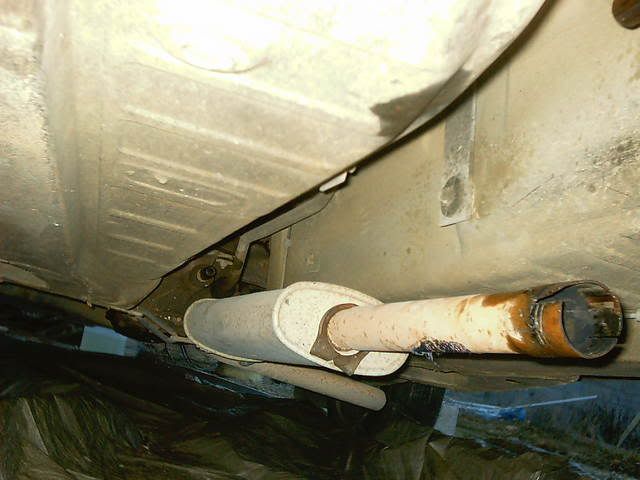

^^The car jacked up and on blocks.
^^Where exhaust down pipe and prop was. 1

^^LOOK HOW GOOD IT IS NO RUST AT ALL ON THE UNDER BODY!!

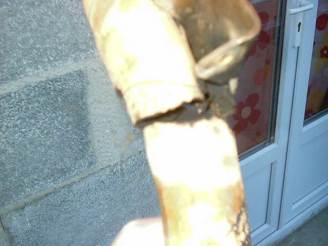

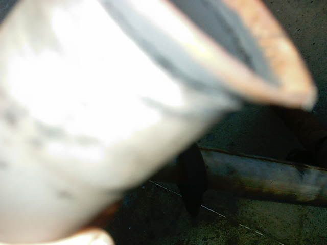

^^Broken Down pipe :( thats where noise was coming from.
^^Hole in neck of down pipe.
^^ total brokeness near braket 1
^^Total brokeness 2

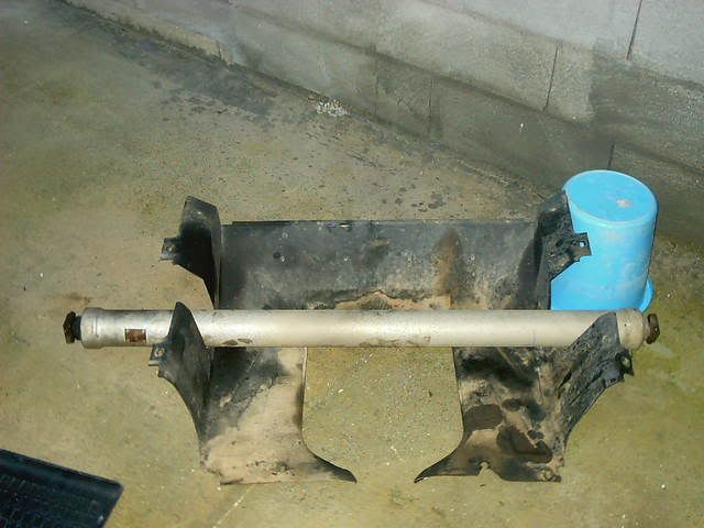

^^ Prop, plastic cover and... :roll: bucket.
^^ Prop.
