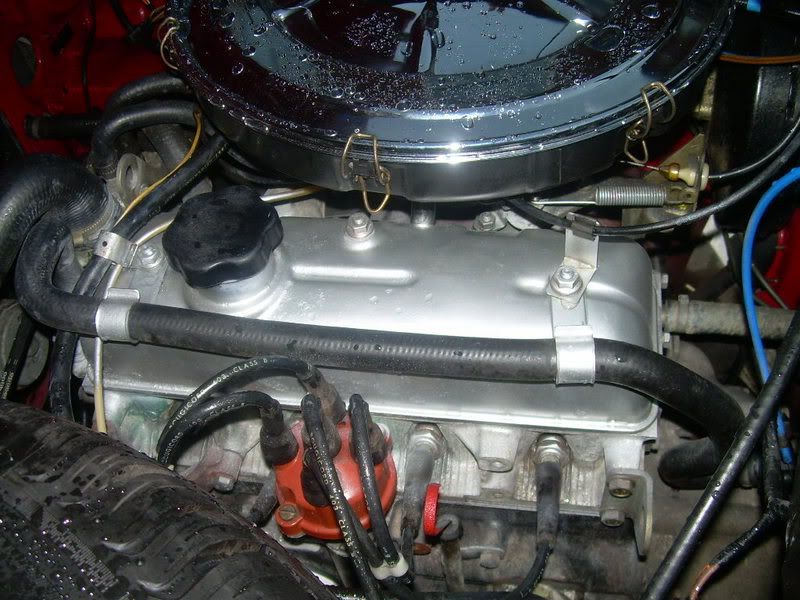

Post by S60-MBS » 06 Sep 2007 08:15 pm
Well guys got the cover off and painted the cover and it looks alot better than before..also painted the freshly sanded exhaust pipe too as it has surface rust as result of being parked for ages..
now i managed to clean out and spray some of the filthy cylinder block too as you can see some over spray on hoses which i will clean tommorow
