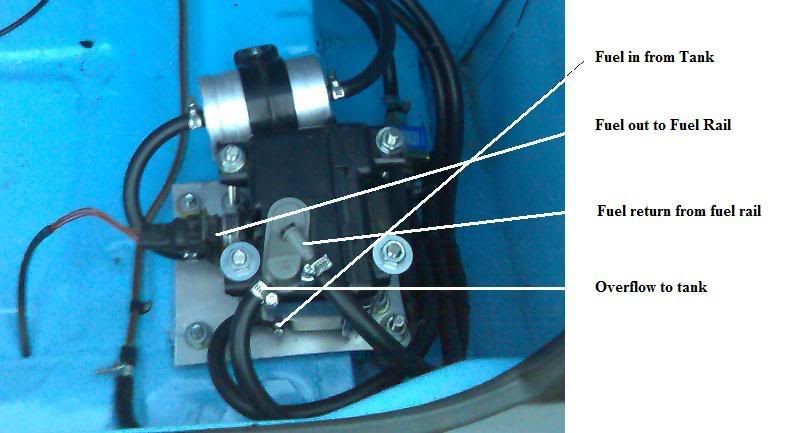

What im going to be doing is running a Golf MK2 GTI 8v fuel pump assembly, which includes a swirlpot,
If i remember correctly you run a normal fuel lines from the fuel tank to the Fuel pump then you run High Pressure injection stuff to the fuel rail. Which will remove the need to mod the tank,
They can be found under one of the rear arches on the golf.

I'm running a Facet red top low pressure pump, into a largeish (1L) swirl pot under the bonnet, then either a 740T or Cav GSI high pressure pump (which ever I find quickest ;)) Theres plenty of ways to do it though!
