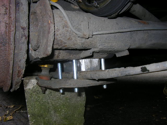

			ok, so after posting on here again i kinda got reminded, hey got some cars to finish. so i decided the suspension upgrade on the volvo might be a quick task.
this has to go in:

								by Cutler » 21 Feb 2010 08:18 pm

								by Dub_Addict » 22 Feb 2010 09:25 pm
			i think your problem may be that the lowering blocks are incorrectly fitted. they are supposed to be above the lowering spring.
- loweringblocks009.jpg (60.17 KiB) Viewed 5777 times
hope this helps!

								by Cutler » 22 Feb 2010 09:34 pm
			HOLY SHIT
Thats one stupid mistake by me! Of course it can't work the way I fucked it up! I had a look at Dai's guide before I went on to fit the blocks but somehow missed to check for the correct position.
Thanks for the clarification!

			Unless I'm missing something, that won't change the shock mounting position relative to the body by more than about 10mm, though.....how much is it out by?

								by bodejodel » 23 Feb 2010 01:59 am
			It will bring the body closer to the shock mounting plate by [block thickness] mm... Or am I missing something?

								by Cutler » 23 Feb 2010 09:59 am
			Jep, about 2,6cm.
I should also be able to gain 2 cm or so by fitting spacers at both ends of the damper. So if the correct mounting of the blocks is not enough, that should do the trick.
