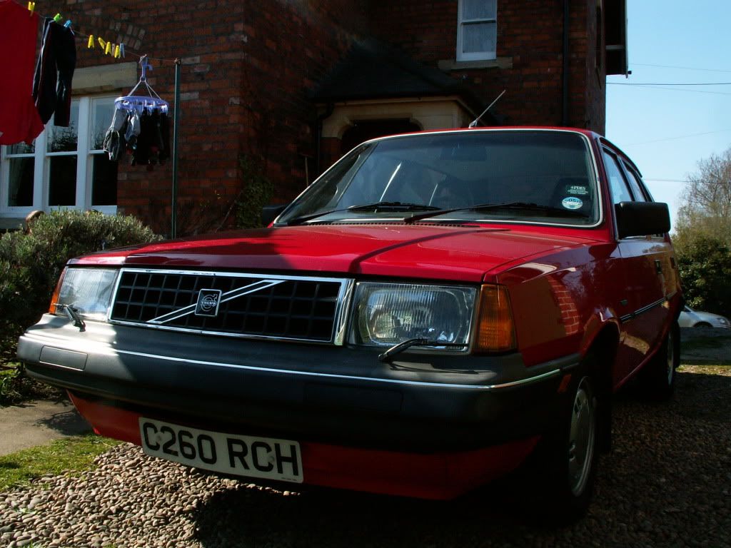

Kris (KrisSWFC) called in today so we could have a look at why the main beam headlights were not working on his immaculate (actually his dads) 340 1.4 GL
Basically everything was fine, except the main beam was not working (not even able to flash).

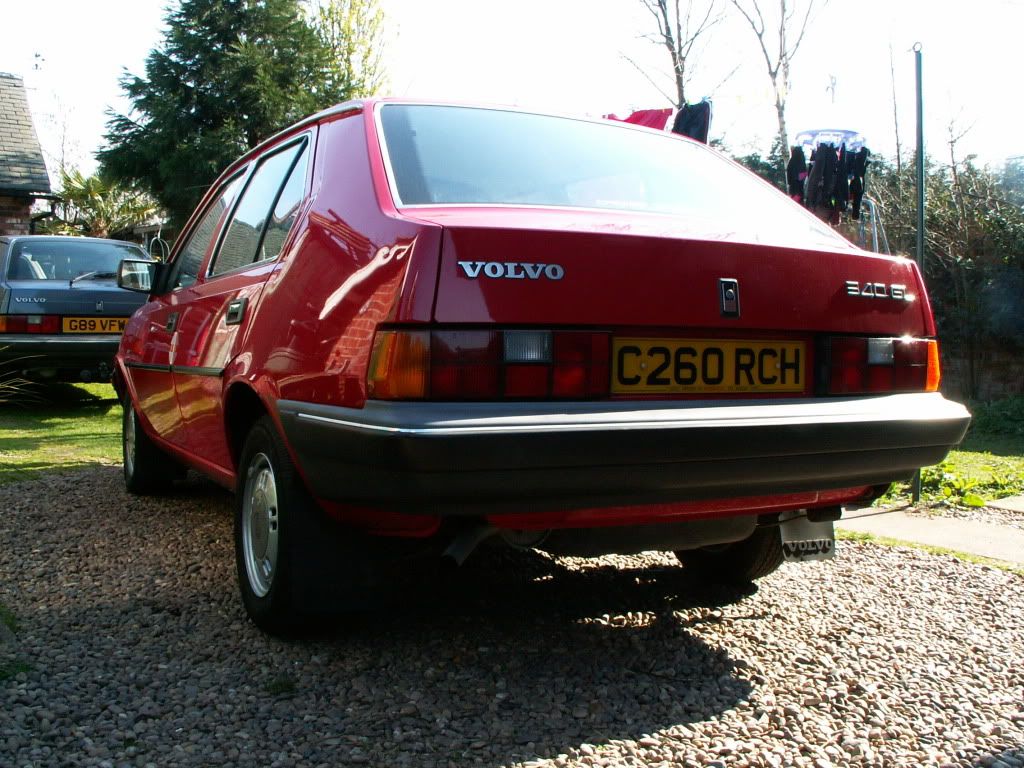

Very nice 1.4 5 door GL, with good red paint (not the usual pink)!
This car really is as good as it looks in the photographs, very original and low mileage.
