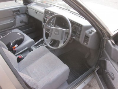

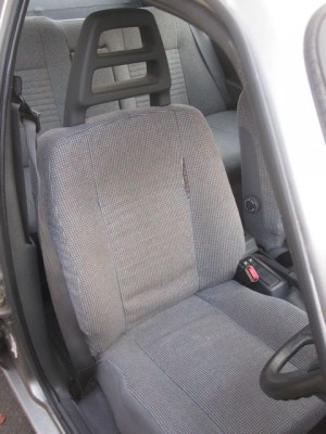

Anyway, enough about me. The car's got less than 43k miles on the clock, one old lady owner from new and in very good nick despite not being garaged. The only evidence of any rust is a small repair to the o/s/r sill, everything else is solid and original, even the front valance. The only slight cosmetic niggles are a split seam on the driver's seat backrest and the fact that some of the segments on the LCD display of the original radio aren't working. On the mechanical side, the engine is as sweet as you like but I'm have one or two intermittent issues with the transmission which I'll post about later in the technical forum. In the meantime, here are a few pics of the car after a coolant flush and a quick clean...
