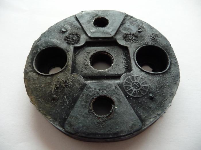

Re: 300 parts still available at Volvo
Diameter for the whole thing : about 74 mm
Thickness: thin parts 10.7 mm, thicker bits with inserts 11.7 mm
Center hole diameter: 10.4 mm
Outer holes, all four: 7.5 - 8.3 (some mould flash inside two of the holes)
Outer holes, diagonally across, center to center: 50.2 mm
I'll get more information on PSA part numbers etc. if it sounds right. It's mounted in a place that's a bit hard to reach unless I need to replace it (and currently I don't...)

Certainly sounds close, I'll try and find mine!

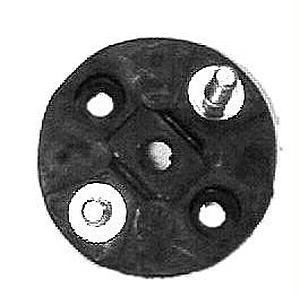

Here's an example of a Citroen steering coupling, with the two bolts included. This looks a lot like the picture in VADIS. If only the measurements are correct...
http://cgi.ebay.co.uk/ws/eBayISAPI.dll? ... 0268618073 For comparison:

That rubber steering vibration damper is a common PSA part. Peugeots, Citroens and even some Talbots and Simcas use it so those are available as aftermarket spare parts.
The same part can be found from at least these vehicles. List below is from this large finnish parts store called 'Motonet'. I've bought one steering damper from there (with Motonet part number 18-1685) and it was the same part for all of the vehicles listed below.

So at least those cars have the same part.
