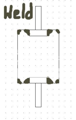

progress soon to come on this, the car will be used for drift days at various tracks around the country in the summer :) i've got a few plans for it fabrication wise, and would like your feedback/suggestions on the following:
- Solid engine mounts - was just thinking of getting tube section the same length as the rubber section and welding on 2 bolts either end, (hexagonal section to be inside the tube part) is this a good idea? i know i havent explained clearly what i mean but i might make a diagram later to help explain this.

here is a 2 minute diagram i made, obviously not to the right dimensions (P.S. if anyone does have the dimensions please let me know!!)

cheers for the link anjo, i see what you mean now - i too am only planning to make the front two mounts solid as they are pretty bent on my one (just took one off to get dimensions)
here is a quick design i made, complete with dimensions, feel free to use :)

made the mounts today:
first got some tube, this was slightly narrower than the standard mounts, but thats no worry. also made end caps out of 4mm steel with a 10mm hole
started to file a taper onto the end caps,
but this was taking forever, so out comes the lathe to make the tapers (this is so that when they are ground flat there is still plenty of weld holding it together :D
then welded that together:
chuck em into a lathe to machine them flat:
job done!
now i jsut gotta fit them. next job is to flush and bleed the brakes
followed by perspex windows for extra lightness :)
