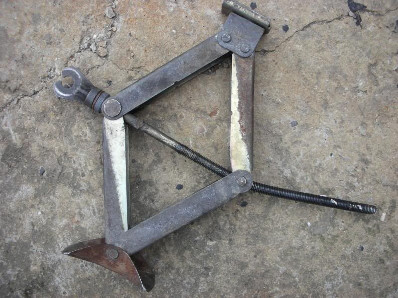

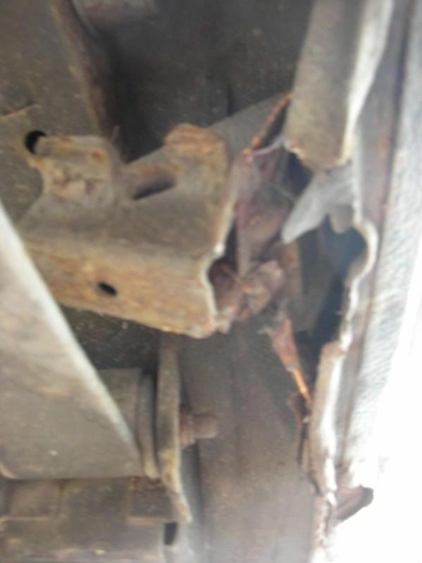

Which intself doesn't look too bad, but the car decided to fall sideways off of it while i was trying to get it high enough to put the axle stands under, gladly i wasn't crushed , injured or horrificcly mamed, but my car didn't get off quite as luckily :(
This is the resulting damage:

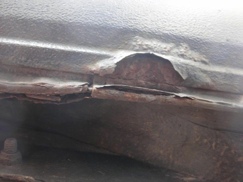

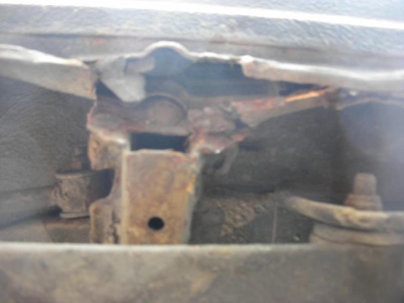

However about 2" or so futher down the cill is this, so it needs replacing anyway, but for now i'll just bend it back and tack weld it back together:

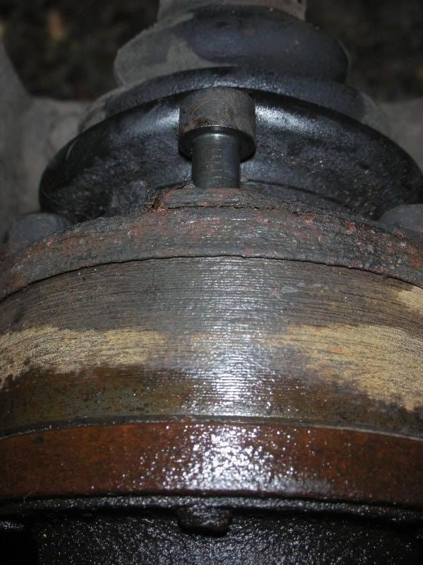

So i use an appropriate jack i.e a proper one, i won't be using a scissor one ever again, and got the axle stands in, wheels off etc ready to remove the driveshaft hexbolts. The first one i started on felt like it was rounding off, not a good start, so i liberally coated them all in WD40, let it soak for a bit before carrying on.
So they've soaked for a bit and i start again and this happened:

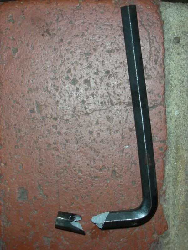

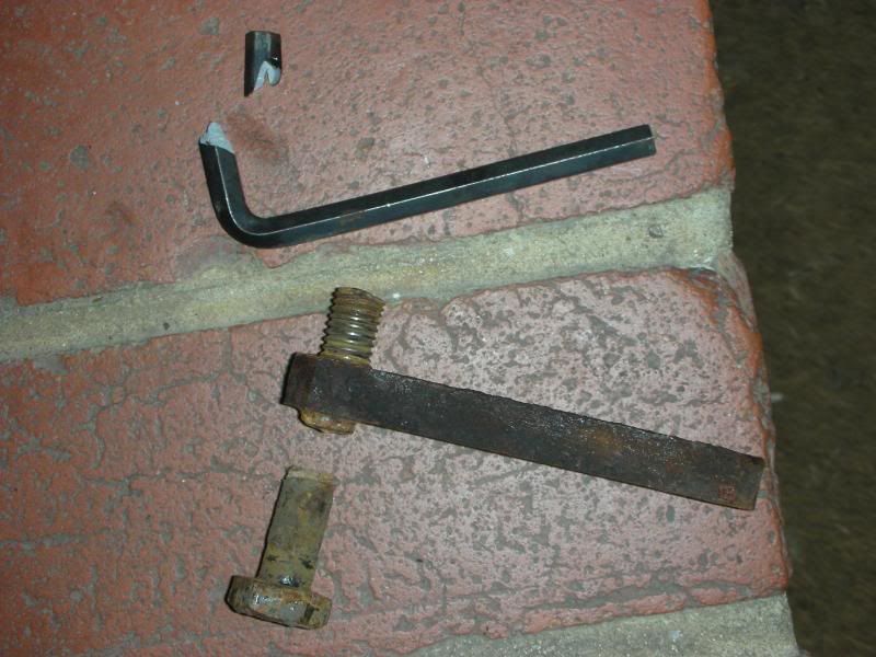

Obviously Halfrauds standard Allenkeys weren't up for the job so i found a proper 6mm socket set style one and carried on. Although they were all SUPER tight i managed to get them all out until i got to the very last one and it seemed a bit tighter than the others, eventually, twang, it loosened but only due to it snapping.
Can you see whats wrong with this pic :roll:
I then spent the next hour and a bit drilling it out, cursing it and getting rather annoyed, i did eventually manage to get the stump out and slice my finger open nicely on a bit of swarf.
Right now just the easy bit of undoing the spring plate bolts. Started on the drivers side, first 3 came out without too much hassle as i had expected, onto the last one with the big washer/spacer type thing underneath it. Should have expected it really with how my day had gone so far, 17mm's on top and bottom then, yep, snap, gggrrrrr! I managed to put the washer bit in my vice and with a massive wrench just about got it out. Next i started on the other side, exactly the same thing, the first 3 came out no problem, then the last snapped again, great! An easy job turned into a bitch due to multiples of snappage.

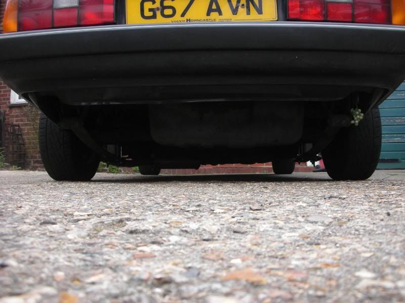

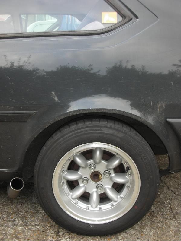

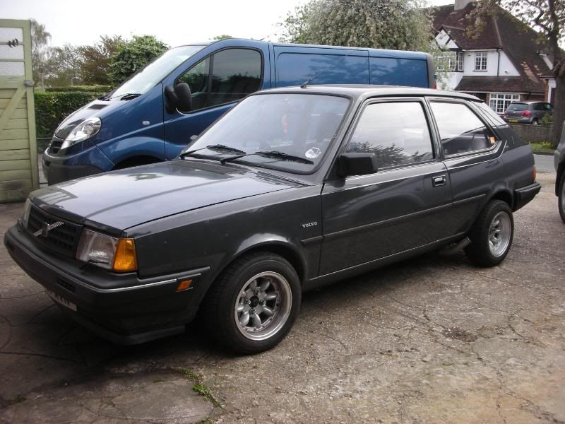

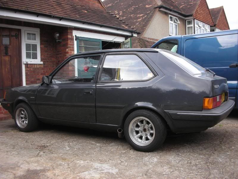

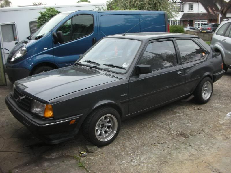

Anyway that was the lows, now onto the highs. Everything was undone ready to have the blocks put in, so after greasing the spacer plate things i wacked them in and put it all back together, this was the easiest bit of the day. I've yet to re attatch the drive shafts as i wanted to get an idea of how low it was going to be, so put it back on it's wheels. Now to me it looks as though the back is lower than the front, which is what i didn't want :? , so do i chop half inch off of the blocks, or bring the front down a bit more with an angle grinder?
The weird thing being if i measure from the bottom of the cill to the floor, the back is 1/4" higher than the front, but visually it looks to be the other way round? What do you guys reckon?

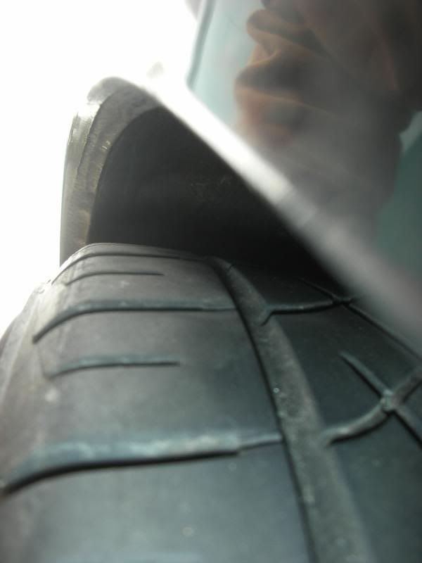

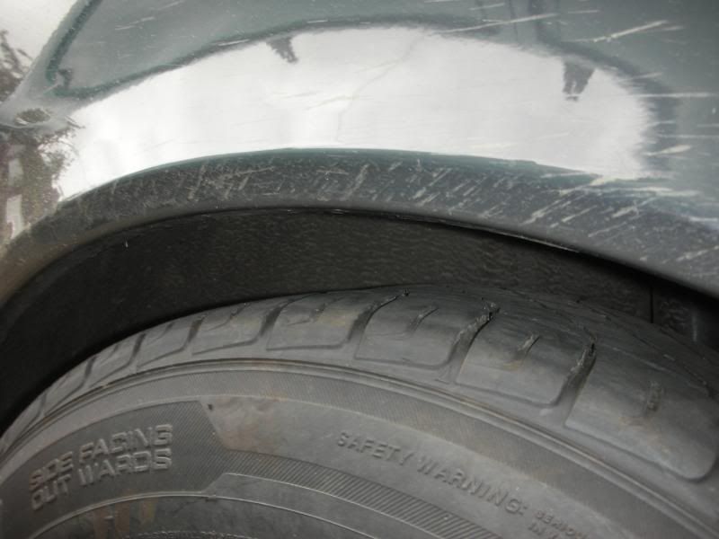

Lastly i deffinately need to get the arches rolled as you can see by this pic, the tread sticks out passed the inner arch lip, yeah i could just get different tyres and get some "tuck and poke" but think it looks gay quite frankly, i like old school fat tyres.

Looks ABOUT level to me. front maybe a BIT higher, but negelable.
Looks mint all round man, thats for sure.
My wellers were a similar offset, and frightened me to bits. :(
Roll em. :mrgreen:

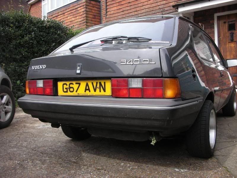

man, what is with those grapes? :lol:

I just saw them in a mates back garden and thought i've got a good place i can hang those :)
Or it's what people in their posh cars get when i whip them off the lights in an old Volvo, sour grapes :lol:

you have to remember though that your front archs are a larger diameter than the rear slightly to allow the wheels not to hit when steering so your car will be about level but just the rear arch sits lower so it looks as if the front is higher
look at the swage line to the front arch then follow it to the rear arch and you will find the rear is a tad lower
