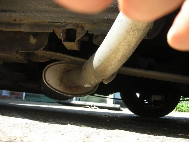

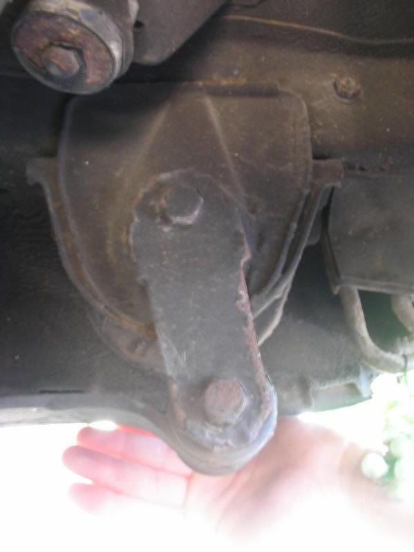

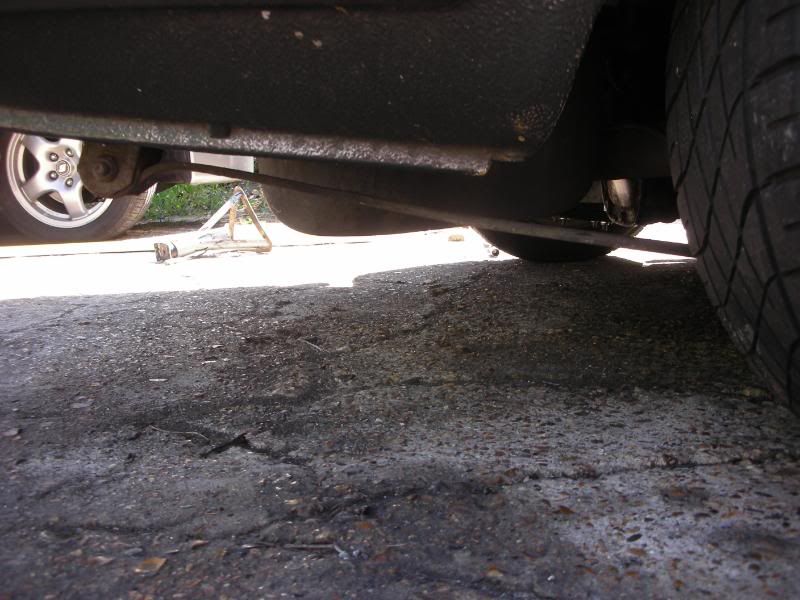

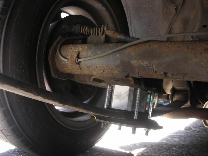

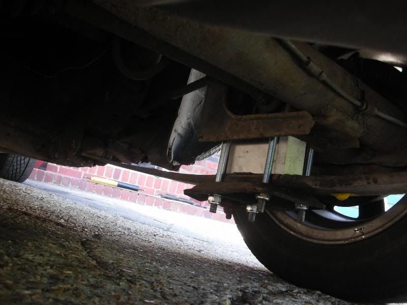

Maybe these pics will shed some more light, i've noticed a difference with the rear hanger on the low side so i'm guessing it may be that, as it's further back than the otherside, hence leveling out the spring? If it is just the hanger is it a case of unbolting it, getting it in the correct position then doing it up again?
More pics.
Passenger side, high
Drivers side, angled rearwards (it's hard taking clear pics in blazing sunshine 8) ):
The blocks in situ, drivers side, the spring doesn't seem to have much curve:
Passenger:
Passenger rear hanger:
Drivers side hanger:

Sorry, thought you had double leafs. Yeah it looks like a collapsed spring to me. Weird that is just went all at once though.
Re: The Battleship,Williams, highs and lows!
Post by Speedy88 » 22 May 2010 04:07 pm
Also I don't know if it is just the light but it appears that the spring isn't a constant curve, it appears to bend more after the lowering blocks to the left. Might just be light distortion though.
