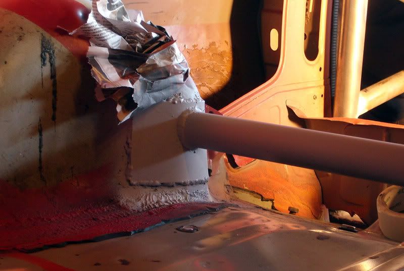

MSA spec only requires that it be built to the dimensions specified in the blue book, if its made from the right materials etc then it will get logbooked fine after a scrutineers approval. If you do a crazy design of your own then it would need to be homologated for national or international competition iirc. Depends on what championships you want to do, but drift stuff is moving toward mainstream style FIA rules.
Nice welding on the cage block looks very tidy, much tidier than my pugs cage plates (well the ones a previous owner had a go at and then I had to correct!!). Though I imagine the volvos are a fair bit nicer to weld to as they are made of thicker metal and don't have galvanise to grind back into what little metal there is too!!

Post by Nikdev » 09 Nov 2008 10:31 pm
All six points welded:
One box:
More detailing
Here is Marius in the progress on the rear x:
Hope to get it done this week :D

Post by Nikdev » 16 Nov 2008 12:31 pm
Jason B wrote:
@nikdev - looking really good! - is that seat a cobra monaco?
Nope still a old, Sparco Sprint
Sorry for pic whoring, the cage is finished welded:D
Rear strut bar:
Testing out the belts:
