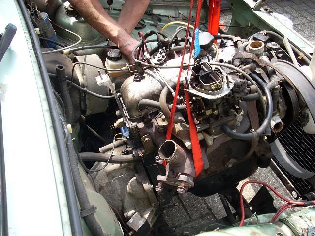

i took of the head;
and reassembled everything to the .4E head;
back onto the engine;
and added a few more bits, coolant fan, radiator, alternator, airfilter, etc.
that's how it sits right now. i started off an hour too late this afternoon, would have had the car running by now
tomorrow i'll finish it and start it up again.

build the last bits back together and filled everything up;
and then it started on the first attempt
really pleased with the result right now runs great again
