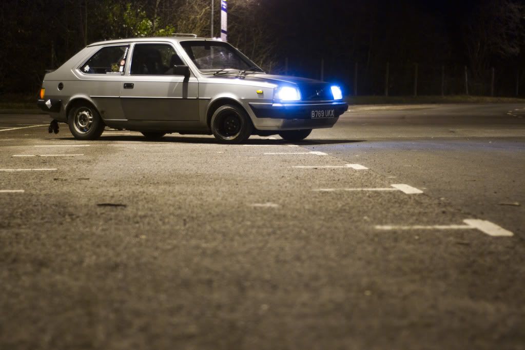

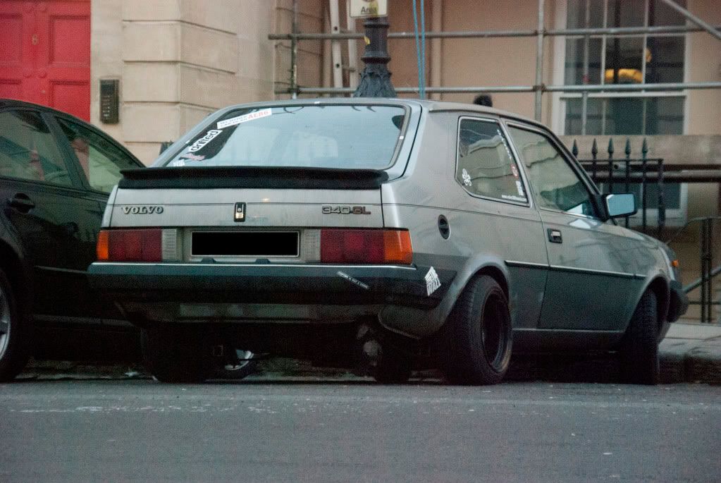

Have a butchers at this . . . . http://retrorides.proboards.com/index.c ... read=38107
and a pick of mine with around 4"/5" (maybe, thats a guess. I know theyre bloomin deep though!) outer lip banded steels (13x9). . .

thats the look im going for..... any more pic of yours??
do you not get tugged with those plates??(black and silver)

No more pics yet. soon maybe though.
And no, I haven't been pulled yet. Stopping at red lights and I've had police next to me, behind me and in front (on different occasions), and they don't seem to bat an eye lid. I've had them on for a good while now. :D
