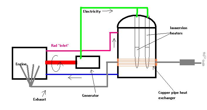

diagram hard...
To fill a water tank with hot water ->
Engine hot water output goes to top of water tank.
Cold water to cool engine comes from bottom of tank.
Leave engine thermostat in place, engine only draws cold water when running temp is reached.
Once op. temp reached engine pumps 80 degree (ish) water to (insulated with jacket) water tank (that is in place of the original car radiator).
Instead of radiating the heat it stores it.
Water in tank should reach 70 degrees or so - how long it takes is anyones guess.
With the temps of -35 you experience you will have to run the engine every few hours to stop the clean water freezing. (cant really have a shower in 70/30 methanol :lol: )
The more you insulate the engine, tank and pipes the more efficient the heating will be.
Obv. you want ALL the heat to go to the tank.

Post by CBA » 01 Jul 2011 12:29 am
To get the engine to full-load a generator running some immersion heaters also in the hot water tank would be most efficient.
Then you have 80-90% of the energy (or better) going to the hot water - you can also use electricity if you need it.
As for the hot exhaust gases - Look at old boiler designs - basically a hot water tank with some copper pipes running through it, run the exhaust through the pipes.
I'll watch some fred dibnah till I find the part where he explains the working behind this copper pipe firebox heat-transfer engineerage. :mrgreen:

Post by CBA » 01 Jul 2011 12:47 am
Diagram.
CBA
Posts: 1071
Joined: 24 Mar 2010 02:14 am
Re: Car motor as generator?
Post by CBA » 01 Jul 2011 12:52 am
Everything should be insulated - Glass fiber, foil and wire to lagg the exhaust pipes. Tubular foam insulation for the water pipes coated with more shiny foil.
Pipes through boiler should be copper- 10mm pipes should be ok, you need enough of them so as not to restrict the exhaust flow too much, and they need to be wide enough so as not to clog with soot (especially if burning cheap and nasty fuels)
Welding the pipes together to make the exchanger will be a challenge..
