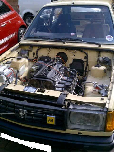

i have now finished my volvo mk2 340 dl to renault megane power the first one to be done i will post some pics up as soon as i can figure out how to do it haha

f7r it has 2mm bigger inlet ports how do i add pics to this page?

Megane head and fuel/ignition?

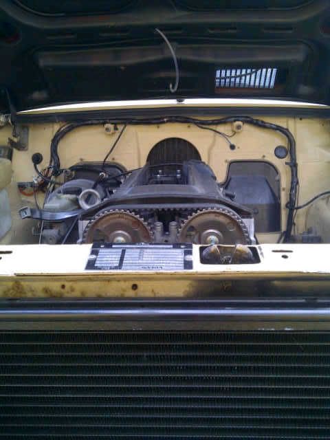

Here you go mate!

Chris_C wrote:Megane head and fuel/ignition?
na complete engine and now runs a dizzie

sm4 jay for popping them up mate
So I see from the pics! so cam from a clio for dizzy drive and head machined? I have a clio head on my megane block, same end result. Looks like a neat install :D

yea not complete got a carbon cam cover still to go on and a few other bits roll cage wheels etc its in the bodyshop getting work done but still running it in had it all lighted and balanced new rings big ends mains done about 500miles so far the head has been machined to accept a dizzie the keyway on the end of the cam is the same dude
