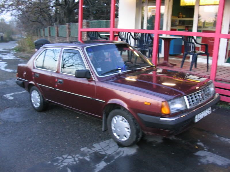

Hi there,so here is my 360...
http://i103.photobucket.com/albums/m140 ... oje360.jpg
http://i103.photobucket.com/albums/m140 ... G_0775.jpg
http://i103.photobucket.com/albums/m140 ... G_0690.jpg
(Ignore the firebird :-) )
http://i103.photobucket.com/albums/m140 ... terior.jpg
Its getting little bit old,rust is on the driver and rear passenger doors,left front fender is rusty on the bottom.. the ventilator don´t work smoothly (stalling).Front windshield is messy(will be replaced in month).Not good starting at all (new igniton cables putted few days ago,starting still bad-mistake somewhere else).brakes are good,engine is little bit lazy but for 22 yrs old car its excellent (i beleive there is less horsepower than 105 which is in the papers).Fuel consumption is horrible in the city (10-12 litres on 100km,on highway 9 ltrs. approx.).It needs new radiator which has leak.I have put new exhausts (except pipes),the rear shocks needs to be replaced immediately,the reverse lights not working (i think its the switching device on the transmission),the turning flashers dont want to return back.. they need to be put back manually (in city its horrible thing).The steering was replaced,because the old was simply wrong.
I have some questions guys.. for what is the diod at the upper left section on dashboard?.. it turns on after 2000 rpm and turns of if i hit gas harder..and another question: what is the wheels pitch on this volvos?.. i need to buy a new wheels for summer and keep the old on winter tires.
