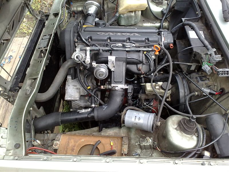

Post by volvodspec » 20 Nov 2009 04:12 pm
on a rhd that is a problem with the 16v head, lhd totally not:

Post by foggyjames » 22 Nov 2009 11:27 pm
I spy with my little eye...
1) A B204FT/GT inlet manifold
2) A turbo casually placed on top of an non-turbo exhaust manifold :lol:
Re: 200bhp engine
Post by volvodspec » 22 Nov 2009 11:31 pm
actually, it is a original B204GT. its the project car of a v3c member, not too many updates recently unfortunatly but it;s a well build car, he's still fabricating it actually.
and zoom the last pic foggy! it's a custom made exhaust manifold and you can see that on zoom :lol: !
Re: 200bhp engine
Post by foggyjames » 23 Nov 2009 12:59 am
So it is! It's so neatly built, I thought it was an N/A manifold...
