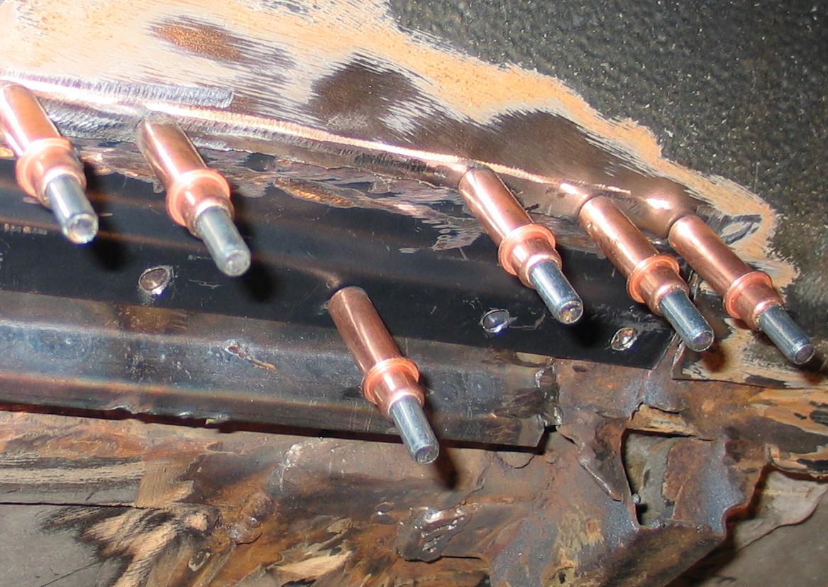

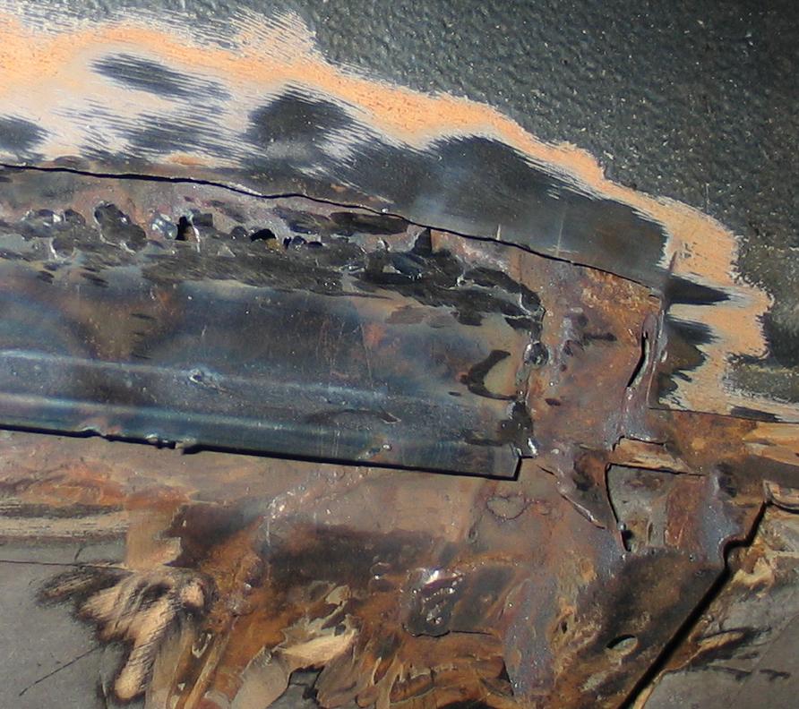

The sill consists of a sandwitch of 3 parts.
1. The chassis, a sort of 90deg edge leading downwards, often floor is rusted at the edge
2. A middle bit with 2-3" holes in it. The bottom bit of it has 3 angles in it including a short bit that heads back under the car and hjust lips over the part 1.
3. The outer visible curved section, that welds to the slanted part of part 2.
Usually all 3 are knackered, unless you get it very early.
I was able to get a local metal fabricator to copy of the lower bit of part 2, I got about 6m for £30. Its not perfect but looks ok. For part 3 I was able to get a complete sill set for £40 from ECP (selling out stock). They were a bit rubbish and designed to be tacked on over the old sills, which is worth a damn in strength and leaves gaps around the pilars etc. I've seen a car with this done, run away very quickly. Anyway I only needed parts of it. I also have the complete sills from a car in good nick that I was scrapping (criminal I know but at the time no demand), but separating these is very difficult and the metal very flimsy once separated. I have used a few bits of it.
Anyway my 360 GLE Saloon restoration is 2/3 finished rust wise (new rear boot panels from Volvo), one sill done, just about to start the other.
