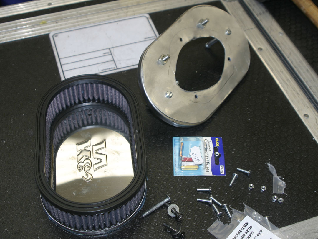

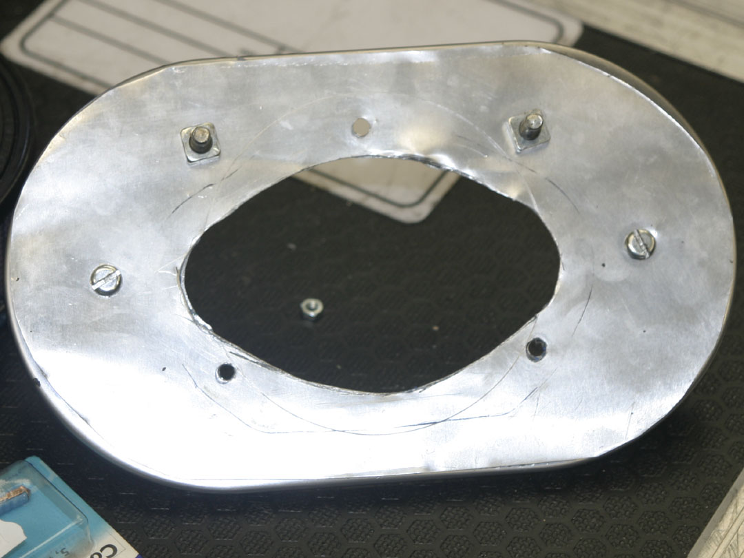

OK so heres how I did mine, seems to be holding up so far and took only a couple of hours at most.
K&N base plate with notches cut out, and some holes added
My adapter plate, with holes for mounting to the carb and filter.
Some gasket, just to improve sealing
adapter plate fitted to base plate, note that later I found one of the long bolts sticking out was getting in the way of the choke leaver and had to be shortened
Fitted!
Fitted!
