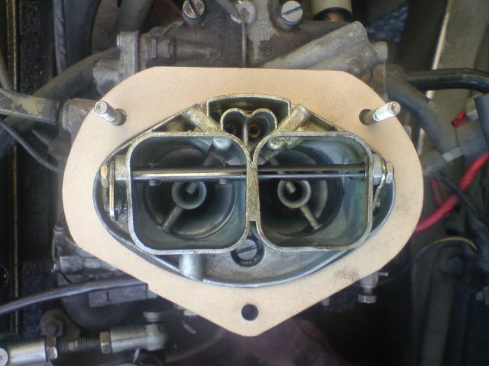

Back to this one. Yes my lump is a B14.4E. I received a package from mac a couple weeks ago but didn't have the opportunity to test out the gasket he sent me. Until now... The original was 0.5mm thick, the new one is 1.2mm - as said, it's a non-critical gasket but it's nice to have one. Mine was already old and cracked. PIctures:
The lower mounting bolt is missing because the thread was wrecked. I ended up sticking a nyloc nut below the carb as a temporary fix, and will try looking for proper thread inserts.
Oh and about the guide - it seems to be very detailed, covering all the different revisions. And so it happens that I may need to use at least part of the information very soon, as I found that the inlet manifold gasket has a leak (between block and manifold) while hunting for a vacuum leak in the engine. Also found a couple perished rubber vacuum hoses but replacing them didn't make any difference yet.
