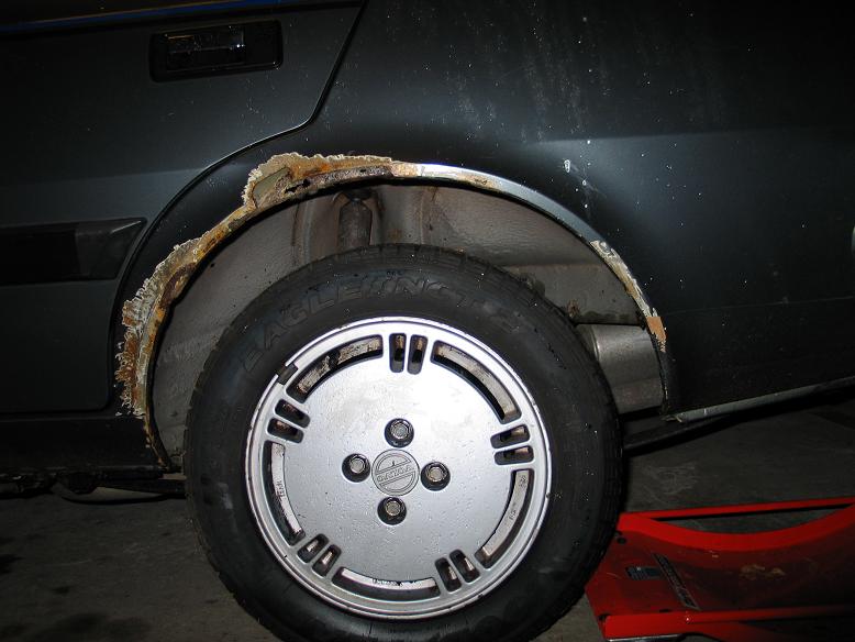

The rear of my 1987 360 GLE saloon seems rather high. It may in part be due to axle bending, and resetting the springs by loosening the bolts may alleviate it, but I intend to straighten the axle somehow.
Anyway when everything is as it left the factory I want a stock GLT look, and according to the brochure pictures, GLTs were lower in hatch at least. I like the well filled wheel arch look, but it should not over lap at the top (ie lower than the tyres), and the wheel should be in the centre of the curves radius visually.
I measured up on the level floor of the garage and got the following (floor to wheel arch)
Rear left: 63.5cm (2 deg toe in)
Rear right: 62.5cm
Front right: 61.5cm
Front Left: 61.5cm
What do others get, particularly GLTs?

GLTs were down 1inch all round as standard, over normal 360 ride hight.
But I cant provide accurate measurements atm.
i can measure my GLE in the morning and subtract an inch?
i DO know that GLT height looks VERY good. 8)

You are best measuring from te wheel centre rather than from floor to arch as wheel/tyre size will alter the measurement.

Anyway here's my measurements to wheel centre (which is harder, since you have to guess the centre), but I agree its better to remove the tyre+pressure variable.
Measuring straight from outer arch corner to wheel centre:
RL: 357mm (also a bit hard on mine since the outer skin is missing)
RR: 351mm
FL: 354mm
FR: 354mm
Take off 5mm for actual vertical height.
I've also measured to very outer corner (not the bottom of the top which is about 4mm down), this is the visible arch (at least in my dark garage). I also measured to the top and bottom of the centre wheel plug and then averaged (this made 1cm difference the case of the fronts from my previous estimate). Measuring straight from wheel to arch is not the ride height, doing the maths, it makes about 5mm difference (less than figure I have measured above).
