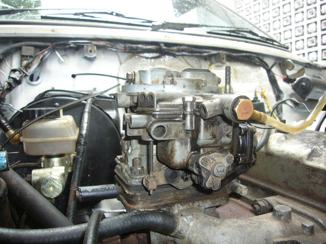

i believe carbon buildup or fuel-cutoff solenoid aren't the problems, the problems are the mess this engine has to cope with. from your pics i can allready tell there are a few pointers wich explain a faulty mixture seting wich mostlikely is the reason for this "diesel" behaviour
http://www.volvo300mania.com/forum-uk/d ... &mode=view
that cover with 3 screws with the W on it, it is mounted wrong. by looking at this pic it needs to be turned anti-clockwise and then mounted, making the W view like a reversed E.
placing this cover on wrong affects partial load fuel consumption, cruising at 40mph is just as economic as cruising at 70mph for you at this moment.
on the carb base there is a hose 5cm long with it looks like something in it, is this hose blocked off completely or does this still have a leak??
the choke cable isn't adjusted properly, there should be about 1cm of unused cable, you have aprox 3cm judging by the pic, is the choke's butterfly valve completely open and the throttle not touched by the mechanism when you have the choke off??
the pneumatic-choke membrame on the right is missing, this means you have a vacuumleak and that makes a correct mixture setting impossible!
also, i see that the heaterhoses are bypassed on the waterpump, but also the carb preheat hoses!! this can cause the carburator to freeze when you drive on the highway, i suggest that you hose this up again, you can do that with normal straight ø10mm waterhose cut to length but if you can find the original hoses in ok condition those will work too
and last but not least, that "custom" ignition system, if you can; build it back to Renix with the 412a mapping. there is nothing better for this B14.4E engine!!!

Thank you volvodspec & CBA
The detail explanation youll made has help me a lot, actually I didn’t know that the Carb was messed up (I replaced it a week back)
I have a vedio clip of my engine started if you want see it please PM me
Carb Version weber 32 DIR 104
Dose any one have picures of the carb and how to fix all the hoses
Thanks agian
i think the air is leaking from there that why it has been block. actually what is that for?
