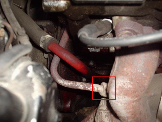

yes this can be done and is a common thing to do on dutch 360's
here;
at the red arrow, there are 2 hex screws; undo them and fit a blanking plate to seal this channel and the egr valve isn't applyed anymore.
what remains is the pipework from the manifold at the right side of the engine:

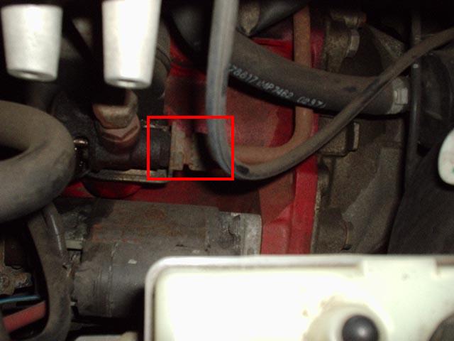

to the valve at the left side of the engine:
the best is to eliminate that too, the pipe can rot away and that gives a tractor noise, annoying at highway speeds.

volvodspec wrote:yes this can be done and is a common thing to do on dutch 360's
here;
Kay so i wanna remove as much as the ERG on my car as possible, so let me get this clear
The exhaust manifold has that line, i could plug that of or take a non ERG manifold to replace it with (got a B230F that has one)
Also all the stuff (valve?) on the last pic.. can you remove that easily.. i have all the greenbooks on the 300 execpt the ERG bit (or do i but i cannot find it?)
