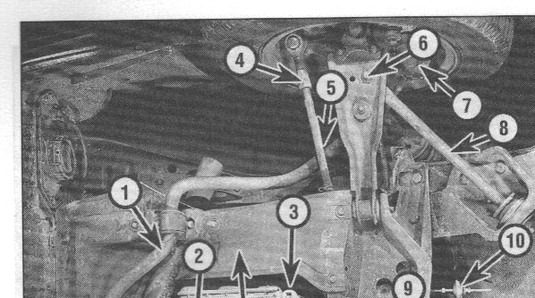

After speaking to the tyre technician Carlos, he tells me it's the lower suspension arm causing me the problem ( number 6 on the diagram) bit on the passenger side. He said that If I could machine the hole to be adjusted i.e. make it move 3 mm to the centre of the vehicle on the cross member, this would align the wheel correctly. As easy as that!!!!!

i think that it's not "6" that's causing the problem but "10", those rear brackets have the nasty habit of corroding and rusting away. i can very much imagine that this will screw up the alignment.kelvingenders wrote:
Re: Negative camber issues - any ideas
Yes I was talking about the top plate as Chris's link shows.
Volvospec, 10 is the clutch cable but I guess you mean the radius arm mounting, either loose or its not sitting right. As the bolt tighten up it pulls the arm shoulder onto the plate. If its not tight metal-metal that will not help, or the mounting can be distorted. You could check by measuring the wheel-wheel centre on each side of the car. It would have to be alot further out to affect the camber, seems it should affect other measurements like the castor, so I'm thinking maybe its not that.
Are the ball joint mounting bolts accurate? Are the bolts the right size locating it correctly?
Try some comparative measurements from either side on the bottom arm length, say ball joint to crossmember.

Hardly any rust on brackets at 10. this is Queensland. It's sunny most days and they don't use salt on the roads.
