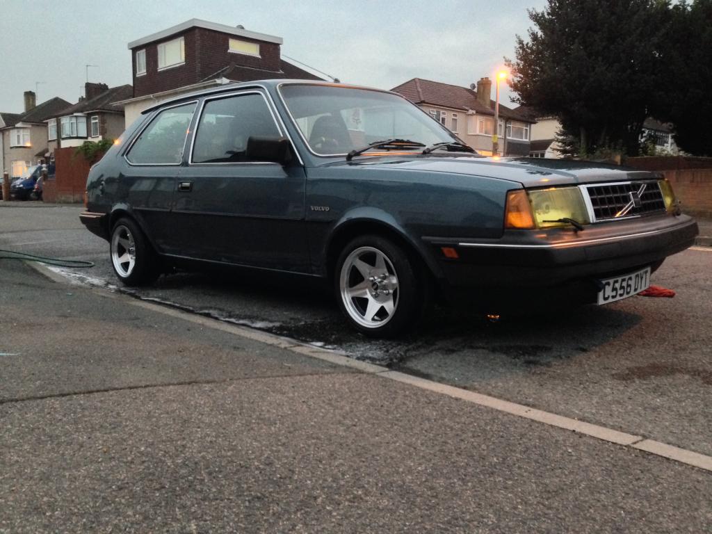

jon-ovlov wrote:Looking goooooood! Always liked the yellow headlights on 300s. Not sure I've got the guts to do mine though. I do have a lot of yellow tint left though, and spare glass . . . .
Thanks I love the look of the yellow. Think you should, can always rip it off ;)

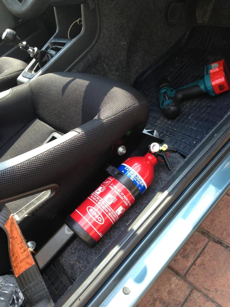

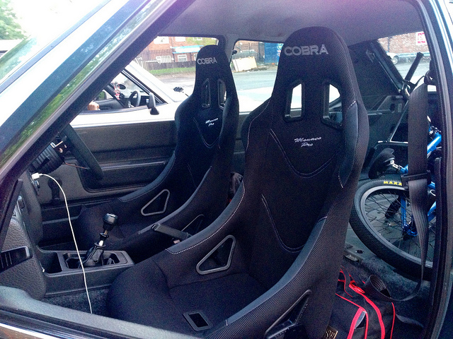

Haven't posted in a while so here it goes… SInce last time i haven't done loads to the car just a few things and I've put the bucket seats in etc.
I just bolted them to the original floor holes using the cobra side mounts and the seat was in the same position as the original one. Just waiting on the harnesses to turn up and it should be looking good inside.

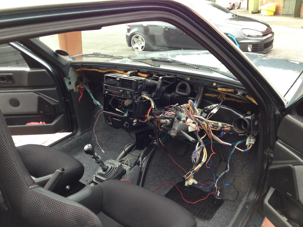

Bought a flocked dash and got fitted it, really does change the entire look of the inside…

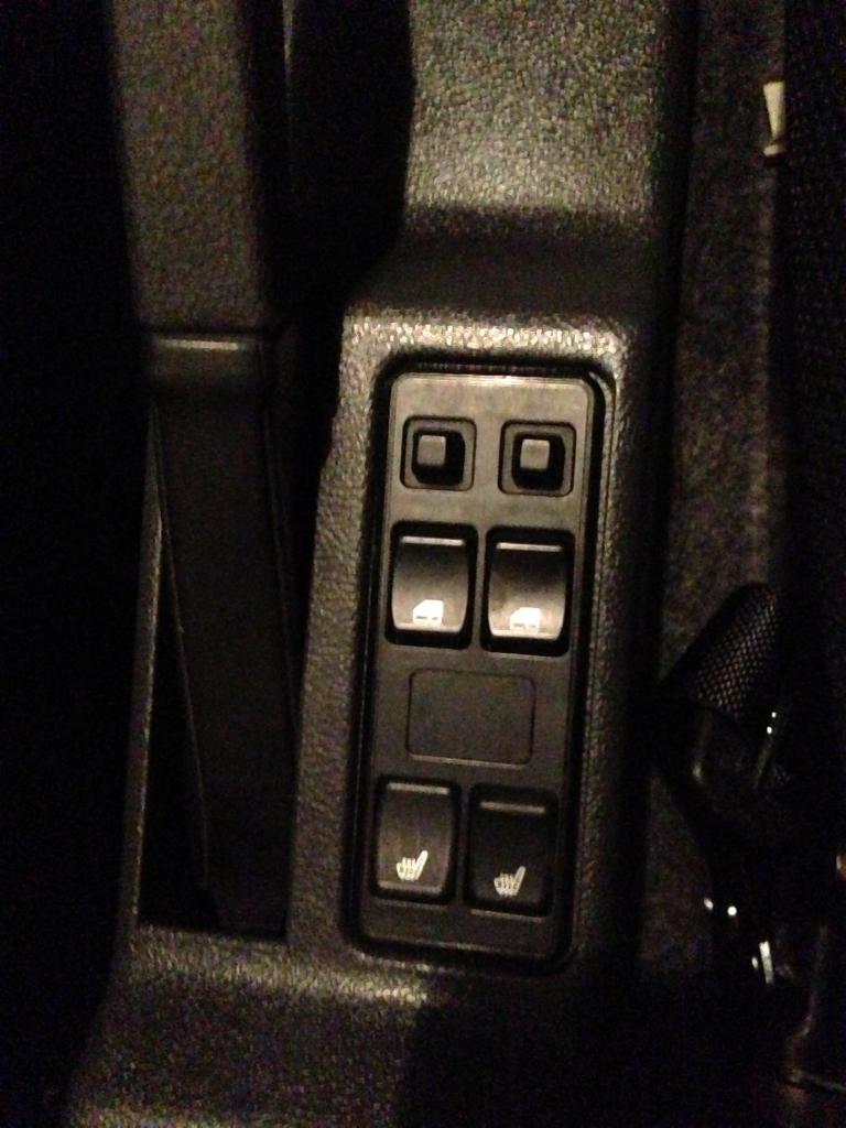

I have also fitted a few electrical upgrades; Electric windows, electric mirrors, central locking with fob, ambient temp gauge, clock etc..
Was able to get the original switches for the windows and the mirrors which just slots in

Where did you mount the rearward part of the harnesses to?
Benfraser
Posts: 230
Joined: 01 Feb 2012 06:57 pm
Location: Dartford
Post by Benfraser »
Nimminz wrote:Where did you mount the rearward part of the harnesses to?
Eye bolt in the original seat belt holes in the floor wherethe back seatbelts would be. Then the luke harnesses clip on and off the eyebolt
