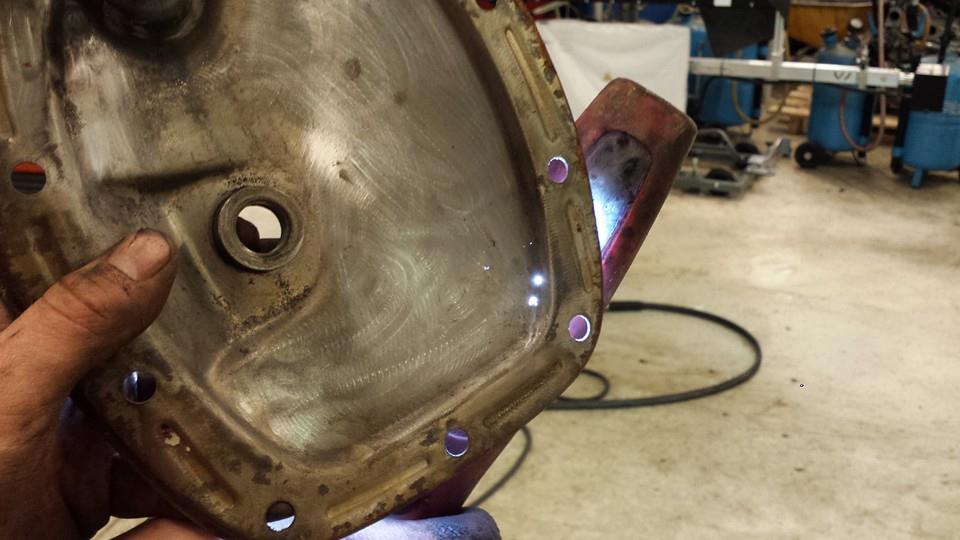

The Volvo repair-saga continues:
Monday I finally got a hold of the new rotor arm and distributor cap. Installed them and car ran pretty good, got some power back and all in all felt more responsive. By the way, if the screws which hold the cap are still original when you're replacing the cap, I strongly recommend to buy new ones in advance. It's a real bugger to fit the old screws as they are chisel-head and there's really not too much space.
Last night I took the car to our workshop and adjusted wheel alignment. As I examined the car as it was on the lift, I noticed that there had been a huuuuuge oil leakage from the diff. By the way, it's really not a good idea to blow pressurised air through the breather tube when you are directly beneath the diff... every part, and I do mean every part of me was covered in yummy diff oil :oops:
Of course the diff cover had given up to the rust-monster and there was a count of 6 really small holes in the cover. Me and my mate took the cover out (one bolt was to tight in that we had to weld a nut to it so we could get it open sm2 ). We managed to weld it up pretty good and put it back to place. When I filled the diff up with oil, two of those fillings started to sweat oil :evil: As the clock ticked at 4 am, I made a decision to fill those holes with silicone sealant. Seems to hold the oil.
This morning I rang up my local Volvo dealer to aquire a price for the new cover. Reply was, that Volvo still has the part numbers on the EPC, but none in stock and will not deliver any more. sm6
Guess, if there's not a aftermarket one available, I'll have to go and scavenge my local junkyard for that cover. But I'll have to dig in more if I could find a aftermarket piece.
Below is attached a picture when we got the cover out and discovered the first holes. Many was to be found after taking this pic.
