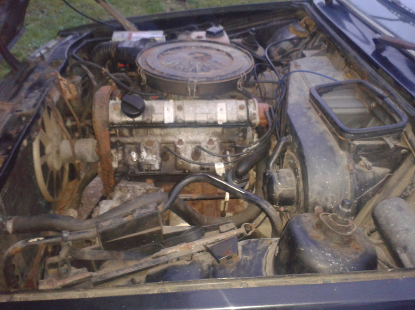

340 1.7cc, B172 engine update Part I:
1) Fitted a cleaned set of spark plugs -old plugs clean but I broke one on removal
2) Cleaned rotor arm but couldn't pull it off the distributor
3) Cleaned the HT leads; two of the metal connectors were dirty & two small metal bits were broken resulting in quite a loose connection
4) Two of the plug end HT leads rubber connectors are bent & make for a loose connection on plug 4
5) Cleaned distributor cap - very fouled with crystalline deposits
6) Cleaned battery earth strap & all connections to earth at battery & to engine block
7) Petrol seemed to have evaporated (over the last 7 years!!) so put in a 5.5 litre jerry can
8) Heavy crystalline deposits around thermostat / hose inlet (just below distributor); removed rubber hose; end of hose & thermostat housing inlet plugged full of presumably crystallised coolant; cleaned this out as best I could & drained out coolant from radiator & refilled coolant system.

2) Engine not idling properly. When I got the car started, because the choke cable is broken, I manually moved the choke on the carb. When I fully closed the choke / carb flap, the engine started to stall; the engine was warm, the coolant radiator had kicked in, so ideally it should have idled without choke.
I'm not happy with how the air filter housing is sitting on the top of the carb; I'm not sure that the three bolts are aligned properly in terms of their respective heights - so I am guessing that there is an air leak there - this could account for the non-idling without choke. I replaced the original carb in May 2006 & it passed the MOT emissions & functioned perfectly until I took the car off the road in Oct/Nov 2007

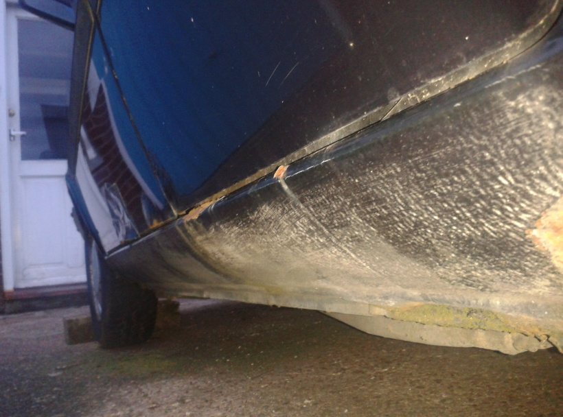

8) Driver's side, rear passenger door sill rusted - maybe 3-4" rust hole developing - didn't want to prod it too much as yet. Again, pretty sure that's an MOT fail

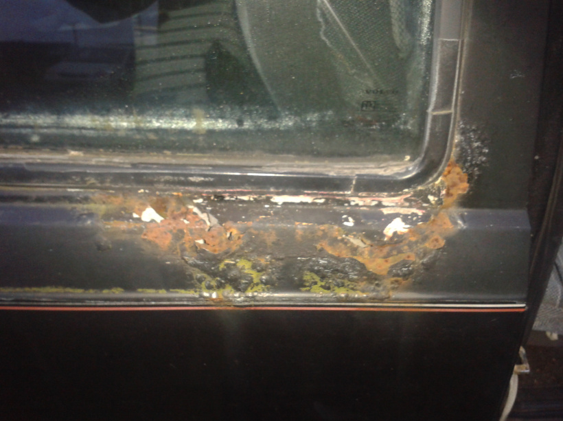

12) All four doors are badly rusted. I know why. The weather strips when I bought the car were bodged. Water gets down past the "weather strips" & into the doors. They could be welded / repaired but water tight weather strips would be required in order to stop it happening again. I haven't been able to find weather strips so far.

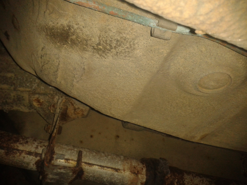

Condition Summary:
The sills look good and, as far as I can see, the underbody is good; rear, roof, bonnet & wings all look pretty good, as does petrol tank. All glass is good apart from windscreen chips but didn't fail 2006 MOT. The electrics all seem to work apart from the electric windows, reverse lights & central locking. Handbrake seems good but I would imagine that, after 7 years with no use, the entire brake system would need a major overhaul - new pipes, discs, pads etc. Can't be sure. The brake pedal seems to function normally. I've never worked on brakes - it's one of my weakest areas of knowledge.

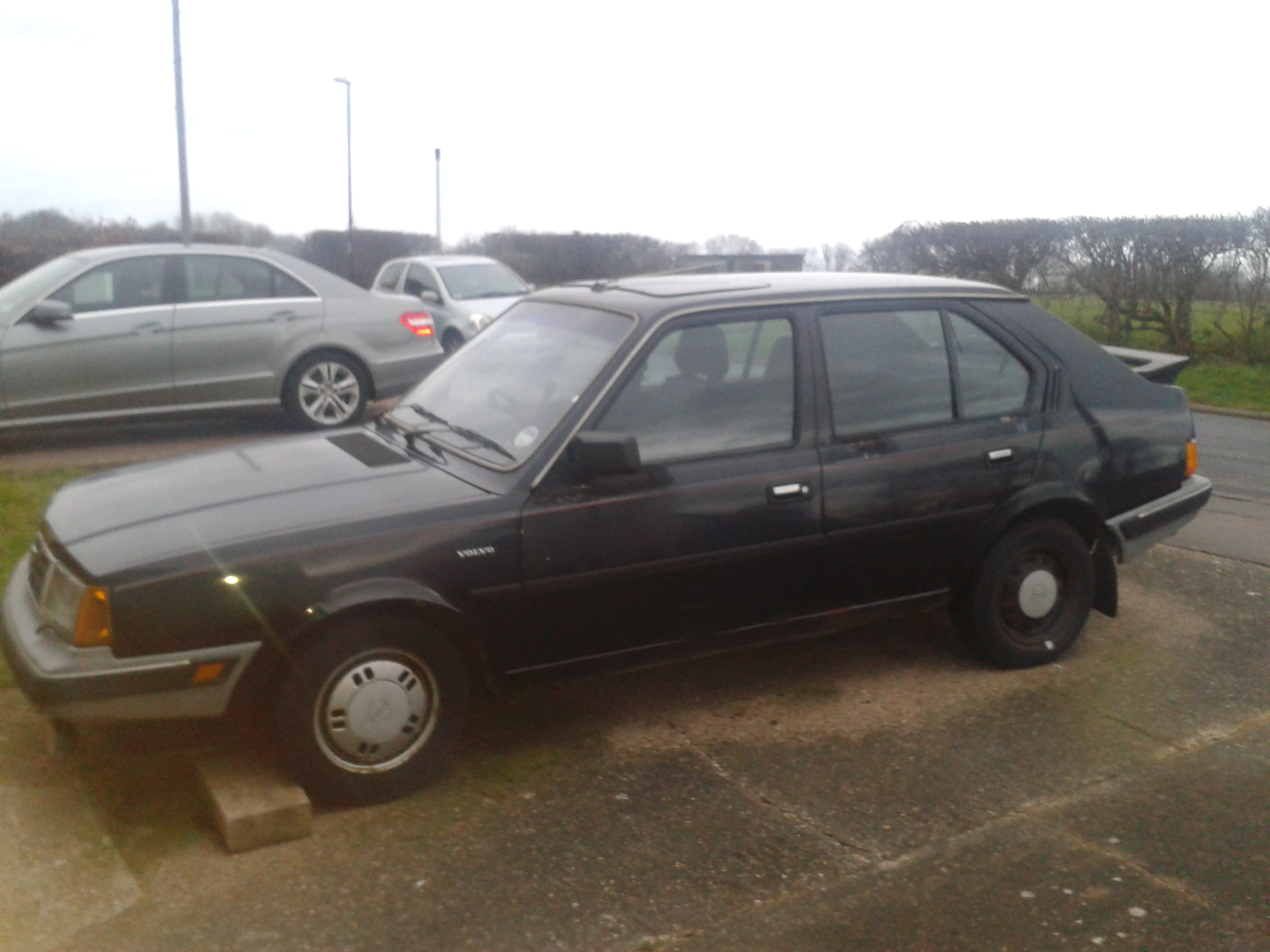

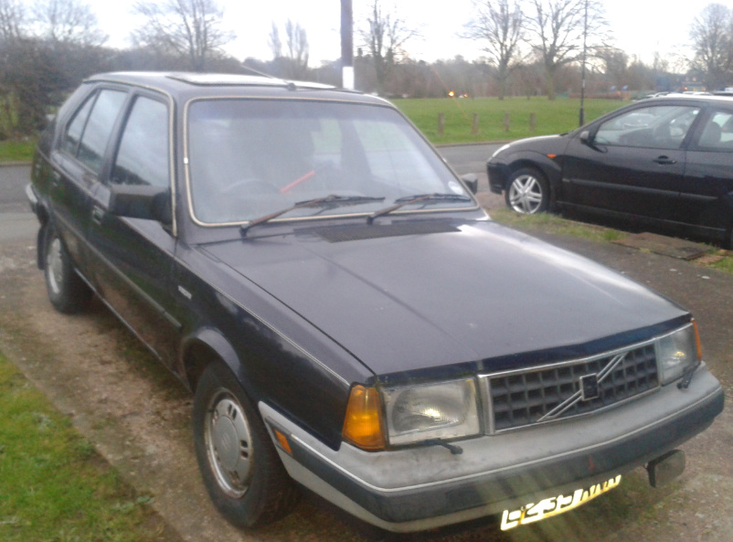

These are the pics. Let me know if you need more.
