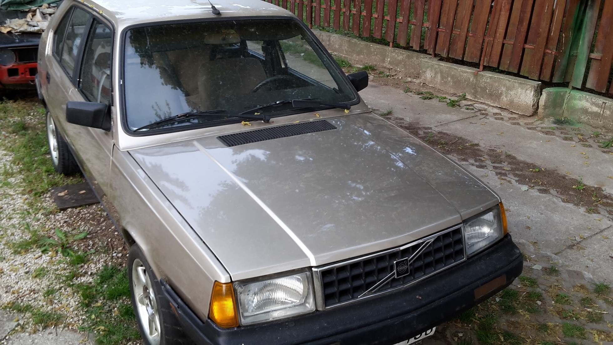

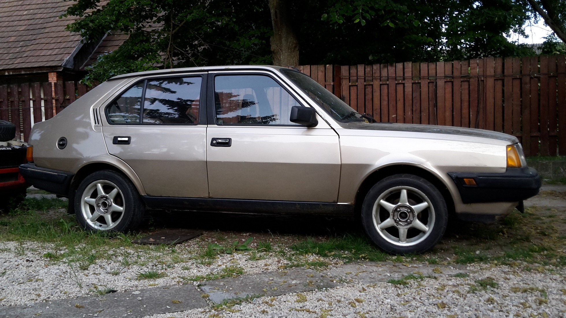

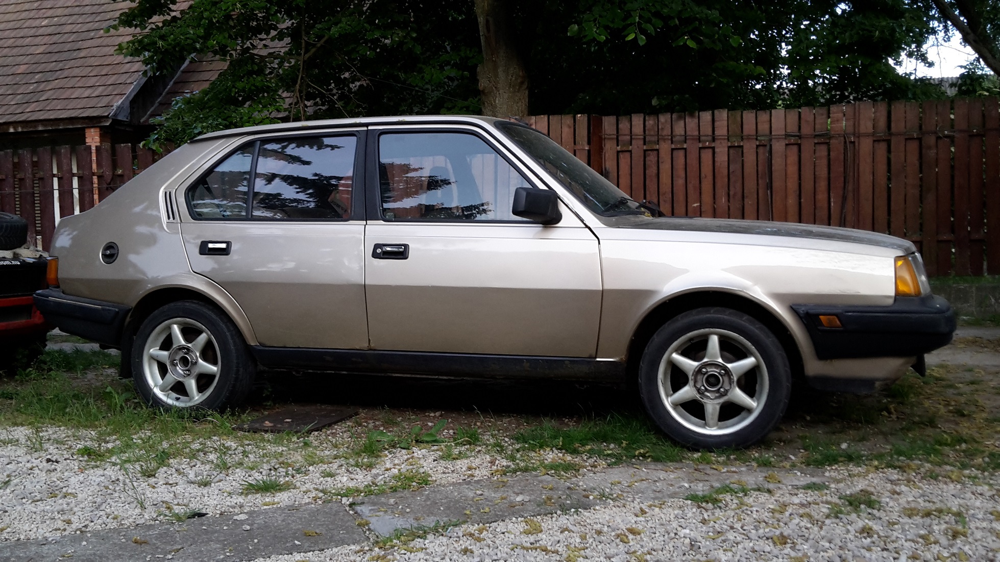

Hey everyone, I'm Okta from Hungary. I was looking for a 360 here but it is quite rare (we have more 340 diesels) but finally found it: a '89 born baby. :D
Not in a bad shape but there are things to do: shifting gears are not smooth, suspension has to be checked, etc. Bought it from an old man, who got this car a long time ago from the first owner - the car has the service book and the original invoice(!)
I will have a dozen tons of question for sure because here only a few enthusiast and did not found them so far. We have quite big VW community here I know because owning one MK1 Golf as daily ride and an MK1 GTI for roadracing. (And a broken one :? MK1 with 2.0 8V -> currently under construction for rallycross...) So know-how of G1 is OK for me and not afraid of some mechanics but this beauty is bit unknown for me so far.

That looks brilliant! One of my favourite colours for a 300 series :D

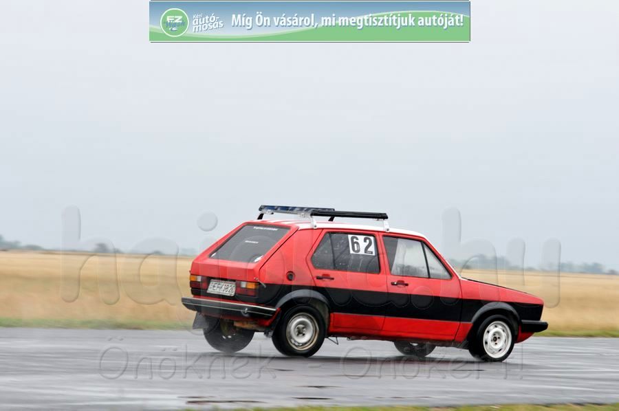

Hi, I'm gonna be banned on my first day here because of posting Mk1s. :D
This is the one before I broke it:
And the GTI:

What model / spec? Steering wheel and bumpers look different than UK spec.
I remember seeing a few 340s in Hungary when I was visiting regularly for work about 6 years ago, seemed to be more there than in N.Ireland. Never see any on the road here unless passing through S.Belfast near McHudds house or the 3 other owners.

360 looks great.
