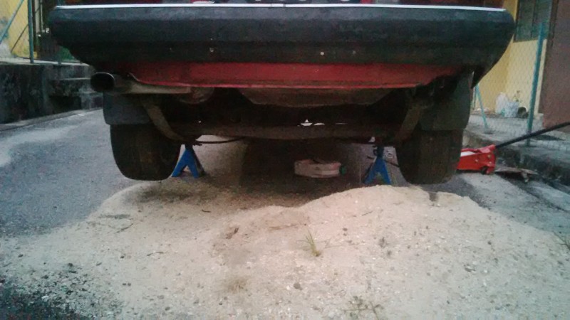

Post by zack360 »
Here are some picture.. I have the trolley jack.
How do I get the gear box down?

Post by bogbasic »
Hello, Its easiest to unbolt the two brackets at the side of the gearbox and lower it down on a jack.

Post by Joris »
Carburetted engines have all the important (supply and return) fuel lines on top of the tank, under the rear seat. You could look at that first, before removing the whole tank. Take out the fuel sender unit, and take a look inside. That should give you a good indication in what state the inside of the tank is. And you can clean the filter and lines at the same time.
