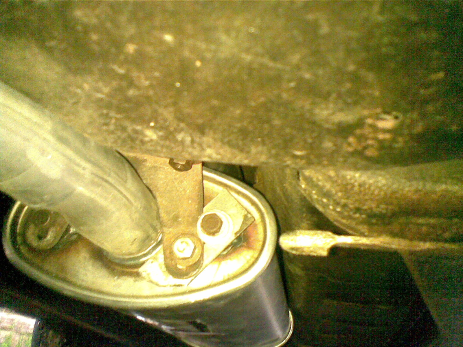

Well, to be absolutely clearius, the new Klarius exhaust section is almost right - just needed a bit of a bodge with the fitting....
.... now, I just need to trim that dodgy fixing plate a bit at the bottom and it might be good to go.

That repair is straight out of Hades. You've outdone me. 340pw
Re: Baffled by 360 exhaust centre section, very.
Post by bogbasic »
Awesome work - I get you now, thanks to wikipedia: Hades the god of the underworld - man, thats mytho-logical ;-0 .... but, anyhow, here's how the final masterpiece looks after removing the sharp edges and it doesn't thrum too much ;-0 so fingers crossed and the MOT man might not mind too much either...
.... shame they can't just make them bolt-holes the right distance apart - they should take a lesson from rabbits ;-0

how much clearance do you have with the exhaust tube in relation to the heatshield under the fuel pump?
it think that the exhaust might get too high when mounted like this
