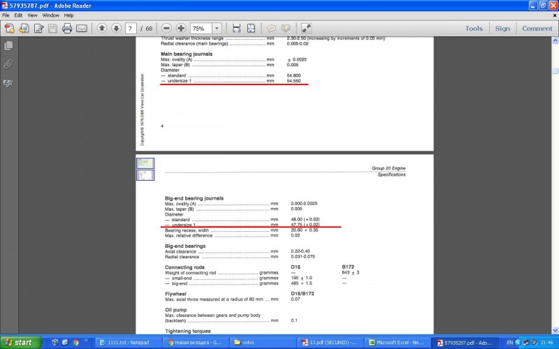

Hi guys, need little advice on oversized bearings for the crankshaft of 1.7
i'm rebuilding my engine, is there only one oversize kind of bearings?
or 30887704 is std size and there are 3287717 and 3344542 as oversize for the 4 bearings, other than main?
on the picture these are parts n11 and 12. And 3 types of oversized thrust bearing (additionally to std size)
Are there any renault catalogs i can buy bearing from? Is it f2n, f3n renault 1/7 engine?
The engine i'm currently trying to rebuild is 1.7 from 400 series (6 bolts on valve cover) but still have original 1.7 from 340 with metal timing cover.
11 3287717 I.DIA 47.75 mm, REPL 1 PCS 30887704.
3344542 I.DIA 48 mm, REPL 1 PCS 30887704., (3287718)
30887704
12 30623800 I.DIA 54.55mm
3486204 I.DIA 54.80 mm
13 3287713 THK 2.30 mm
3287714 THK 2.35 mm
3287715 THK 2.40 mm
3287716 THK 2.45mm

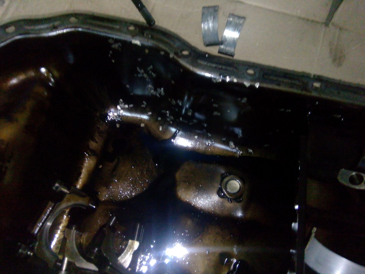

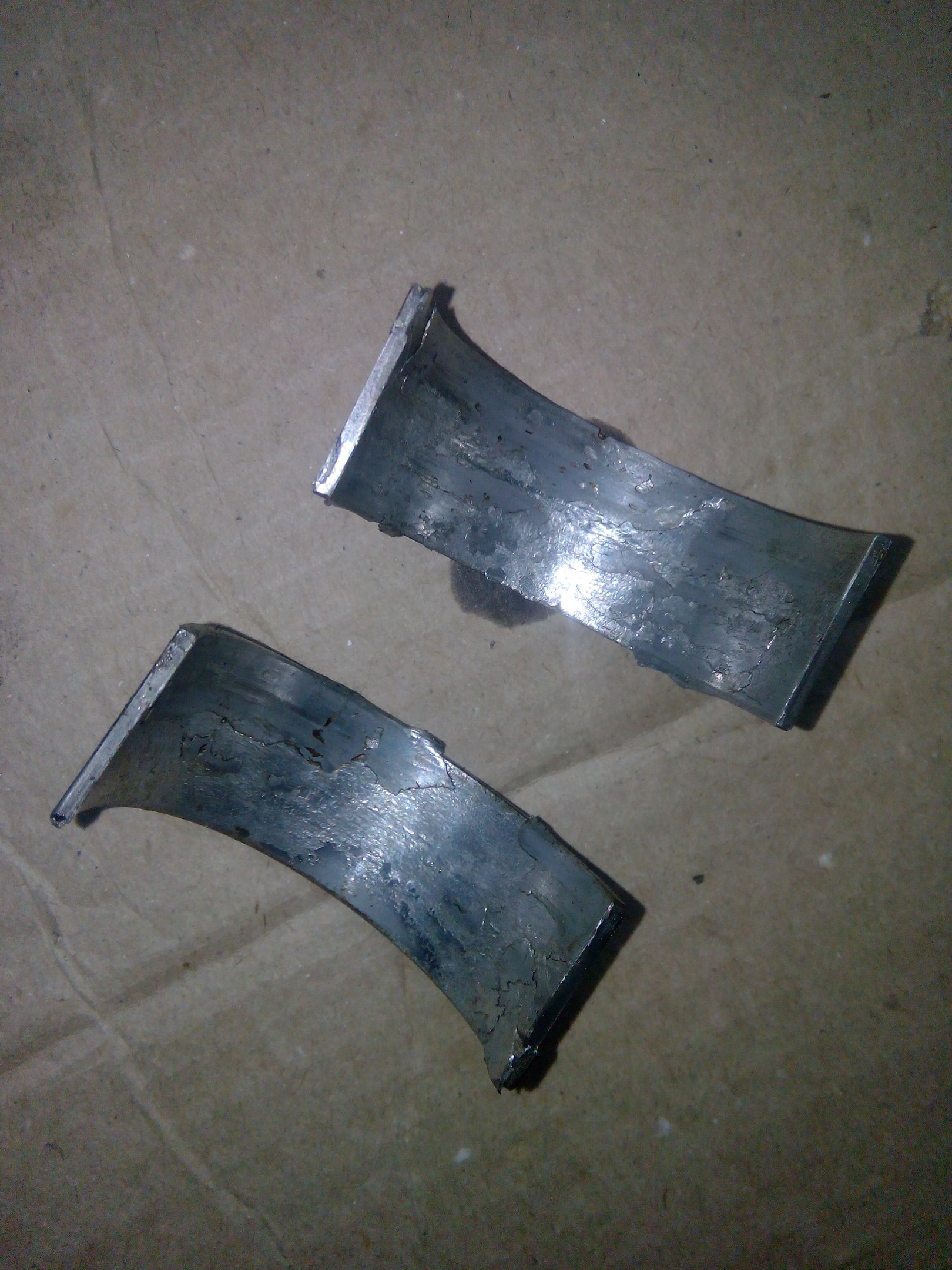

Spare crankshaft is now at machine shop. they'll try to machine big end bearings to first undersize and main bearings to what they think necessary.
Crank that came with 4xx engine cut bearings to this:
Re: 1.7 crankshaft bearing sizes
Post by bogbasic »
Wicked work. How do bearings get that bad?
Chris-m
Posts: 55
Joined: 16 May 2015 03:52 pm
Location: lincolnshire
Post by Chris-m »
Some ones done a proper job on those bearings!
Looks like alot of heats gone through them, often caused by people driving along in a high gear doing low speed, puts extra strain on the crank, causing the oil on the bearing face to burn away quicker, causing a lack of lubrication
an un-lubed bottom end always ends in tears :lol:
