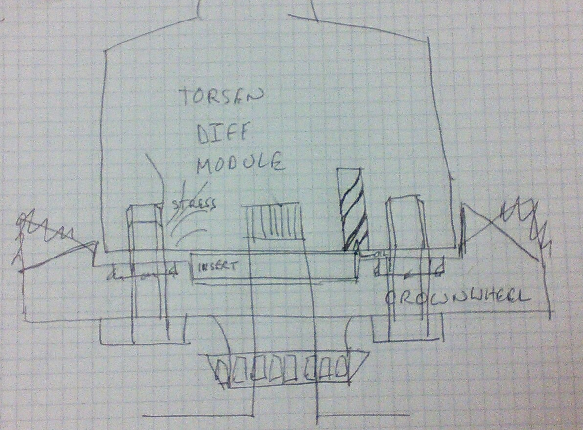

The diff module is the same size as best I can measure as the Volvo cage, although the edge is a little damaged.
The deeper reason for the problem is that (in my case at least) the insert for the crown wheel lifts the mating surface of the module and leaves a gap between the 2 parts around the bolts. The base of the diff module is full of (purposful) holes and quite weak to the bolt torque bending the outside edge against this insert.
The insert (came with the diff) is very smooth and the helical gears rotate against it halfway across the insert outside egde. It maybe designed to suck oil from the gap or not rotate against the less smooth mating surface of the crown wheel.
gap in bolt area
gap in bolt area
Either;
1. The insert is too high and needs shaved down or
2. Its not flush for some reason or
3. It is designed this way and a much lower torque is needed or
4. I need to shim the mating surface around the bolt holes and close the gap

Tonights exciting installment is that I think I have the problem.

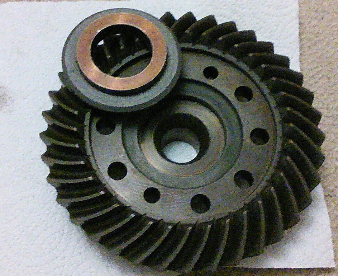

After getting my heat assembled insert out with a newly invented technique due to lack of liquid N, some measurements indicate more of the story.
The insert seems to be designed to be flush with the surface, the lower step is shorter than the crown so cannot bottom out leaving a gap and the top step seems to be within 0.05mm heightwise as best I can measure. The problem seems to be the outer diameter that is 77.3mm when the hole in the crownwheel is 77.0. The corners look ok (ie not interfering) but its hard to be sure.
So my solution would seem to be to trim down this outer dia by 0.2-0.3mm. This is stopping my diff module bedding down on the crownwheel properly.
Atchi, is it possible to check the drawing or with the mfr to see what it should be. Do I have an out of spec part? Is the design intent to be flush? Is it meant to be an interference fit?
Please note my measurements are only reliable when considered relatively. I can get a more calibrated absolute measurement in work if necessary.
Insert and crownwheel

Not much progress today but one of the other guys who hadn't fitted theirs also had similar measurment with 0.2 over on the insert diameter. They also had the main unit over-sized by 0.2.
If the tolerances need to be tight you need to measure a number of OE units to determine the actual manufacturers specification otherwise its a fettle-fit and its possible the mfr intended this.
Sounds like you need a machine shop to fit this, not quite a straight swap unfortunately.
