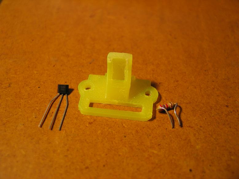

This is for later fuel management systems (or MPGuino MPG meters) that want the vehicle speed in pulsed form. I'm not 100% sure it is needed for LH2.4 and I havn't my car to test it on yet. You pop out the false panel on the back of the VDO speedo and this screws in. Its a copy of the one fitted to injection 440s, Mk1,2 Golfs etc.

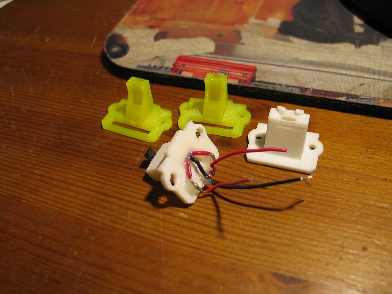

I have some prototypes ready for self assembly if anyone is interested. It requires some soldering and gluing, I can stretch to building a few for testing but I plan on giving these away as a kit and pretty cheap. I'll even make the design accessible on-line for anyone to print themselves or pick up from a local printer. The should be usable by VW owners too.
The kit will probably consist of:
An axial resistor
A 3D printed holder
A Hall sensor
2 screws
Instructions
Both sets of proto's needed a bit of wittling, but this is just a holder at the end of the day. As long as it close enough to the rotor to pick up the magnetism and not so close as to hit the speedo needle ring it should work fine.

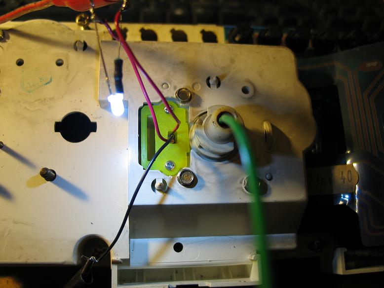

I'm looking for 2 testers to try these out for fit and function, you need to wire them up at least to an LED+resistor then spin the speedo with a bit of wire bent at the end.

I guessed there would be difficulties with real world testing in projects, this is why I suggested testing with an LED on the bench fitted to the speedo. If you have the speedo out you should be able to test it.
An assembled test unit will be delivered free to keep, to 2 people willing to put in the test effort. I could probably even supply it fitted with an LED that you cut off. So you just need to fit it, supply power and twiddle the speedo drive with a standard bit of car wire while checking the LED and needle.

Re: Vehicle Speed Sensors
BOM
1 x 2k7 1/4 axial resistor
2 x No.2 x 9.5mm self tapper screw
1 x A3144E through hole hall switch
10mm x small heat shrink
3 x 7cm small gauge wire
1 x 3D printed holder (will be available on Tinkercad so you can order or print your own, Search for Vehicle speed sensor VW Volvo and request 100% solid)
Pea of epoxy glue
1. Form the hall sensor by widening out the legs a little and bending the plastic part at 45 degrees to the legs, the widest part should face out (down)
2. Form the resistor to attach to the outer 2 legs and to be bend back on itself
3. Pre-tin the resistor and sensor legs then solder, use a croc clip + tweezers jig to hold (will add photos later)
4. Strip and solder the wire to the legs, don't linger or you'll melt the resistor off
5. Put the heat shrink on the middle leg and slide up close to the hall sensor, heat to shrink (without melting the solder)
6. Fit the lot into the holder and bend the hall sensor 90 degrees, bend the resistor down flush with the holder.
7. Glue the hall sensor and wires with epoxy at both ends and the resistor, use minimal amounts to ensure the epoxy does not protrude too far. Arrange something to hold it in place while the epoxy hardens, or consider super glue initially.
Testing I have attached an LED across the resistor (12V in and output) and pushed in a bit of wire with the end bent a little to catch the drive. The wire is twiddled and the led should flash 4 times per rotation, it will keep its state when you stop so the led will stay on or off depending on where it is. Turn the dash around and view the needle while spinning the wire, you should see the needle rise to about 10 or 20mph, it will only work in one direction (clockwise).
