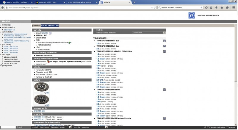

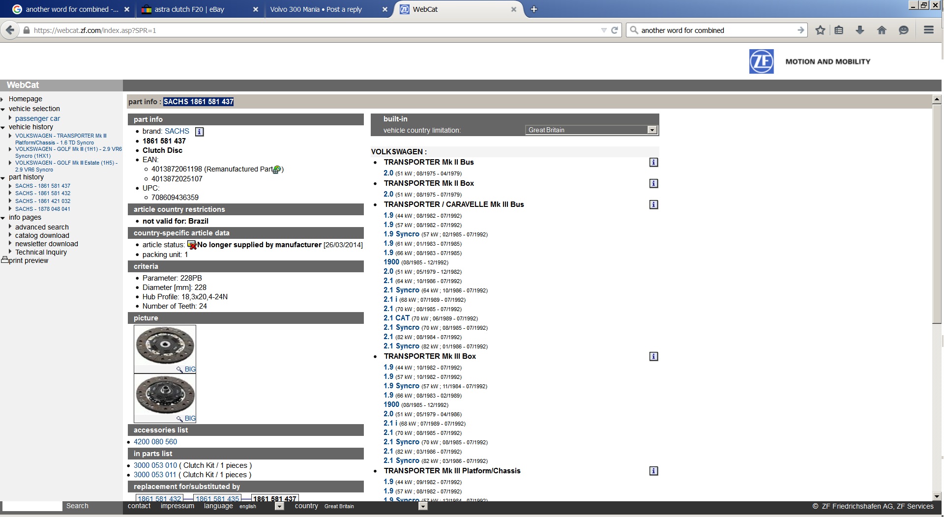

Check ZF webcat, not seeing GTI stuff, but there are a number of years/options I only checked 2.
The VW transporter has the same spline number and 228mm dia and I have heard people mention it. Whether the thickness is good or not I don't know, the Audi one are too thick and not much space for shims. The Vauxhall one is for a high performance application so might be better.
VW TRansporter disk
VW TRansporter disk
SACHS 1861 581 437 has A few hits on ebay
There are a number of other hits where aftermartket replacement might be availble.
