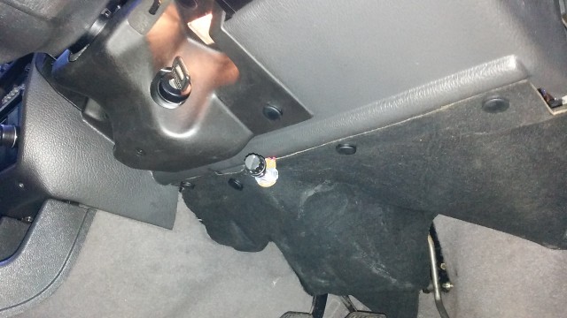

Re: Electronic power steering progress.
Post by bogbasic » 13 Apr 2017 11:47 pm
Converting other 1.7 now. Not so elegant removal of the ignition switch backplate is in progress...

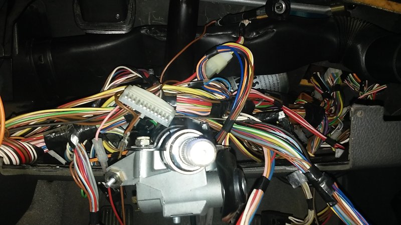

Post by bogbasic » 19 Apr 2017 10:13 pm
Its all a bit more apart now with the ignition switch and column bracket removed.

For replacing the relays, here are some notes.

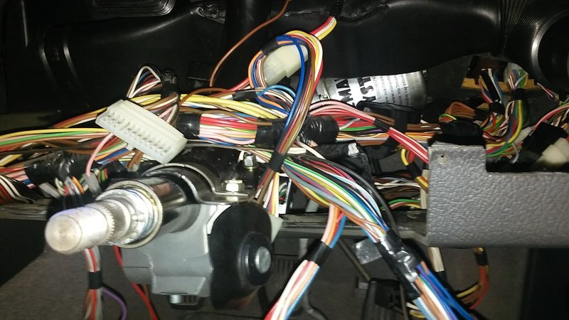

Post by bogbasic » 17 Jun 2017 10:55 pm
Hello again folks, a bit more progress on the power steering for the deep blue beastie.
It is all wired in and seems to work well when tested, so it shouldn't be long now.
N.B. I think I had the black and white wires the wrong way round at this point which causes the power steering not to work. I also remember that one of them had to be connected elsewhere in the end to make sure that the PS only came on when the ignition was switched on, otherwise it stays on all the time and presumably drains the battery or knackers itself in no time at all. So whilst the black and white wires look wonderful slotting into that connection block, it is actually incorrect to wire it this way, sorry!!
