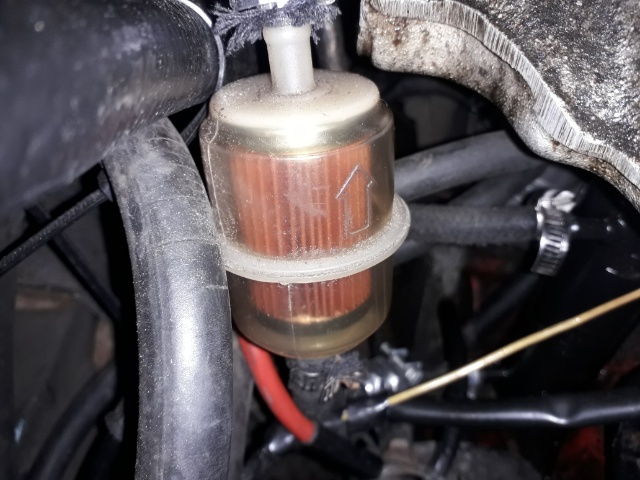

The car started after 2-3 weeks standing with fuel level in the filter really low and on a fairly flat battery. Non-return valve seems to do the business.

Thank you. I drove the 360 yesterday without any problems. The non-return valve seems to solve the problem as the car always starts now. The mixture is a bit rich, though. Maybe, a tweak of that well-hidden screw is needed. Cheers, bogs.
Re: 360 carby fuel supply
Post by bogbasic »
Yo! The car was left standing for a week of fairly solid heat and it started after a few tries, so I think its more-or-less fully sorted by the non-return valve.
