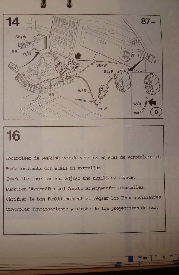

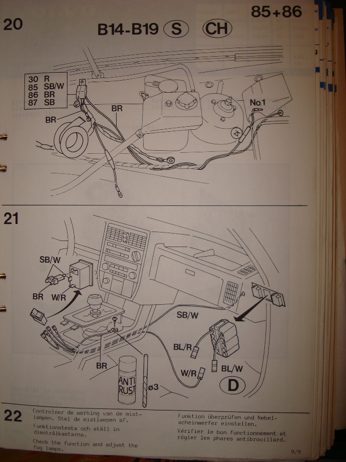

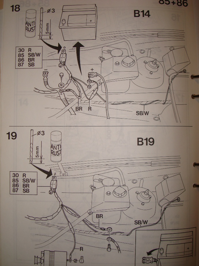

Mate, here are some quick pictures that I made with the camera, it's from my magical ring binder (binder"s" I should say :D ) with hundreds of blue leaflets :D
The 2 first pictures show the situation utill 1986 and you will notice that there is something specific to Germany in the wiring!! (maybe Volvo had to take into account the fact of maximum 4 lights working at the same time you talked about!)
The 2 last pictures are from another blue leaflet from 88, there is a little difference between -87 and 87- models. And again the little square just for Germany! :wink:
I hope it helps.
