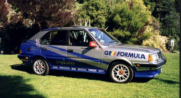

Hi I just bought a 360 GLT but when I put in any gear it doesn't drive.
There are no nasty noises some one told me it could be the drive coupling but it is really quiet, any ideas out there, thanks.
Here is a pic of the car, it cost me $200 NZ.

That picture used to be on the web loads about 5 years ago, will be interesting to see it now! Any recent pictures?

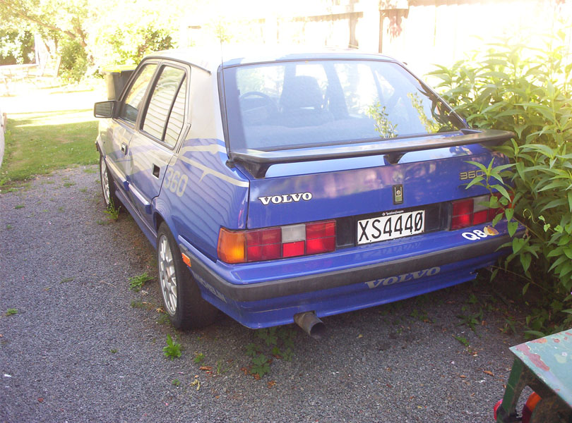

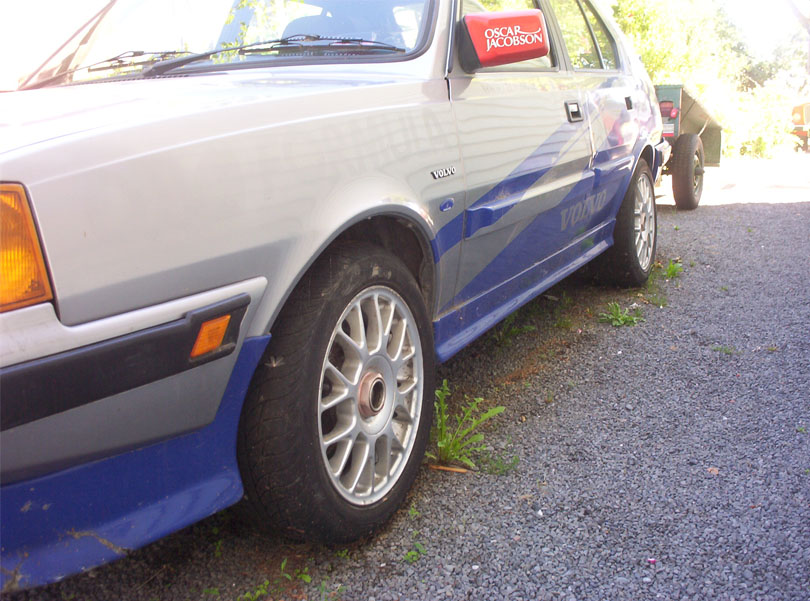

Heres some pics taken today. It was originally built up by a local Volvo dealer for his daughter, she wouldn't drive the original "Granny" car as she called it.
It used to park outside my cycle shop reguarly and was kept in good nick.I never saw it for a few years until it came up for sale last year. I'd been looking for a 360 and was stoked to see the BTCC car. Got it for $200 but it's been sitting since, no time.
Engine runs great I just need to sort out the drive problem. It has a genny Volvo body kit apparently and had power steer fitted.
Most of the decals are gone on one side so I will take them all off and just keep the silver and blue with a repaint.
Its still a real tidy car just needs a little tlc.
