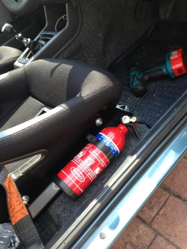

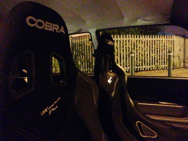

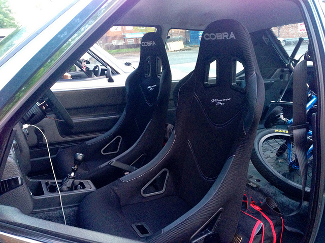

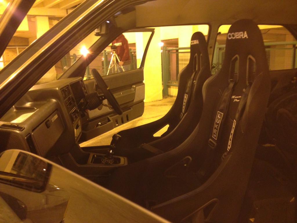

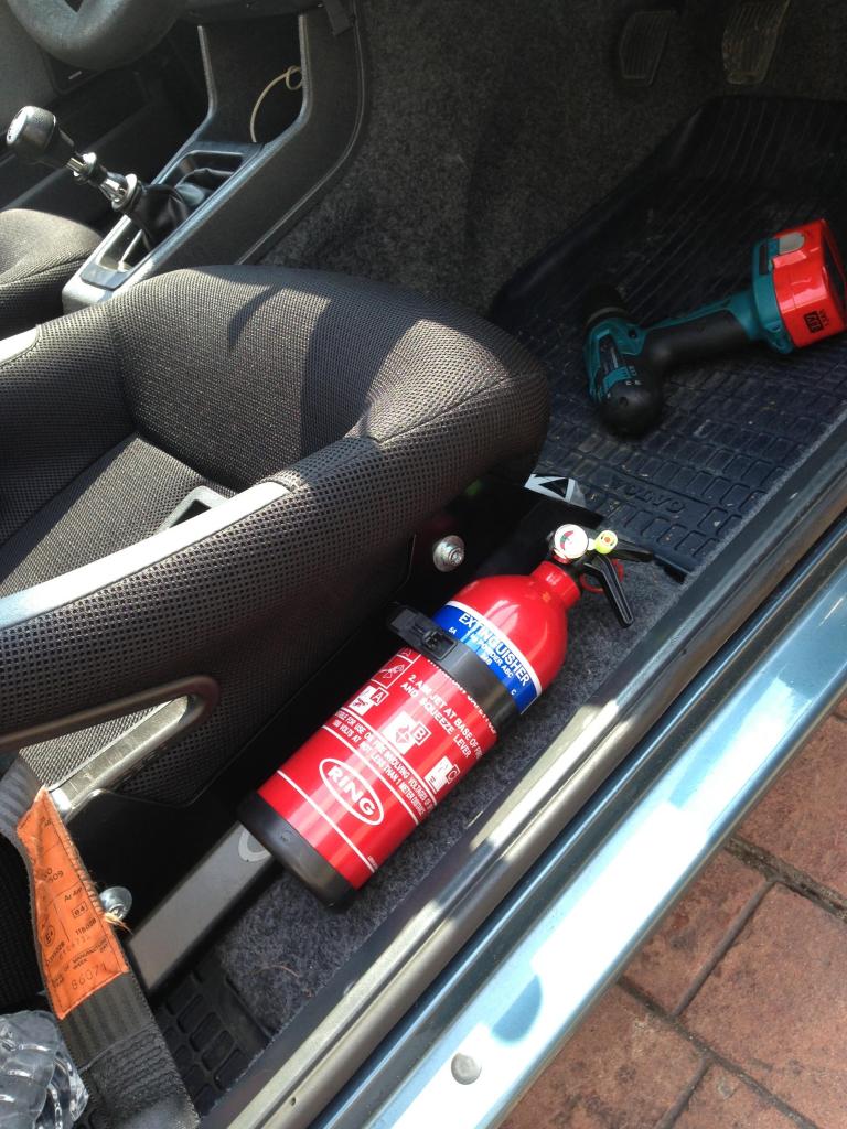

Haven't posted in a while so here it goes… SInce last time i haven't done loads to the car just a few things and I've put the bucket seats in etc.
I just bolted them to the original floor holes using the cobra side mounts and the seat was in the same position as the original one. Just waiting on the harnesses to turn up and it should be looking good inside.
Haven't done anything else much just a few pics of the car…

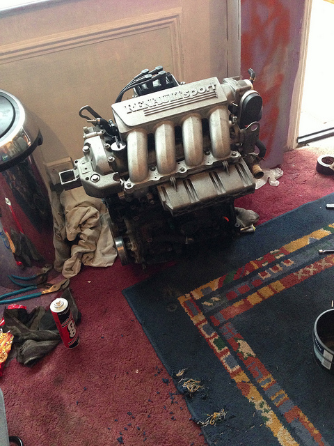

Ohh and i also picked up a cheap clio 172 engine that i was going to attempt to fit but have now changed my mind as they're too much hassle and I'm going to pick up a f7p in a week or so and then I'm going to be starting that which should be eventful! Heres the f4 engine which is also for sale if anyone wants it!
Ben…...

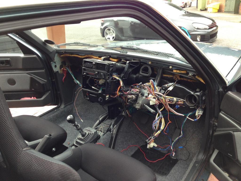

Update… Just some pictures of some things since last time.
Harnesses

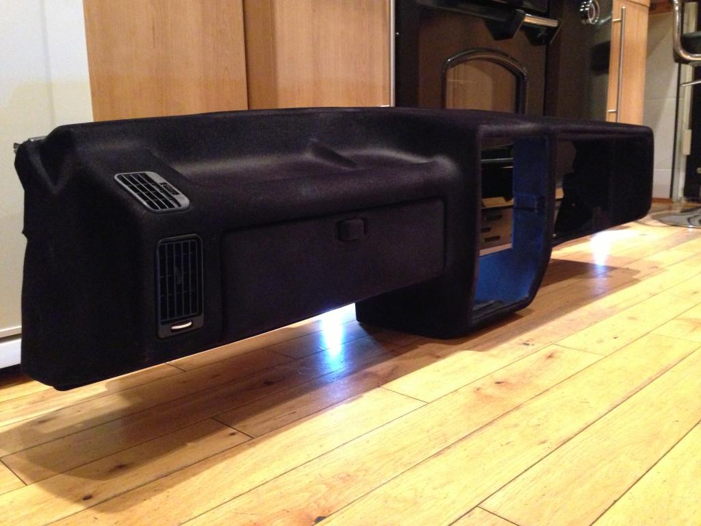

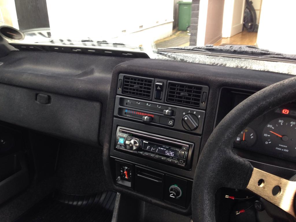

Bought a flocked dash and got fitted it, really does change the entire look of the inside…
More to follow!…..

Following on…

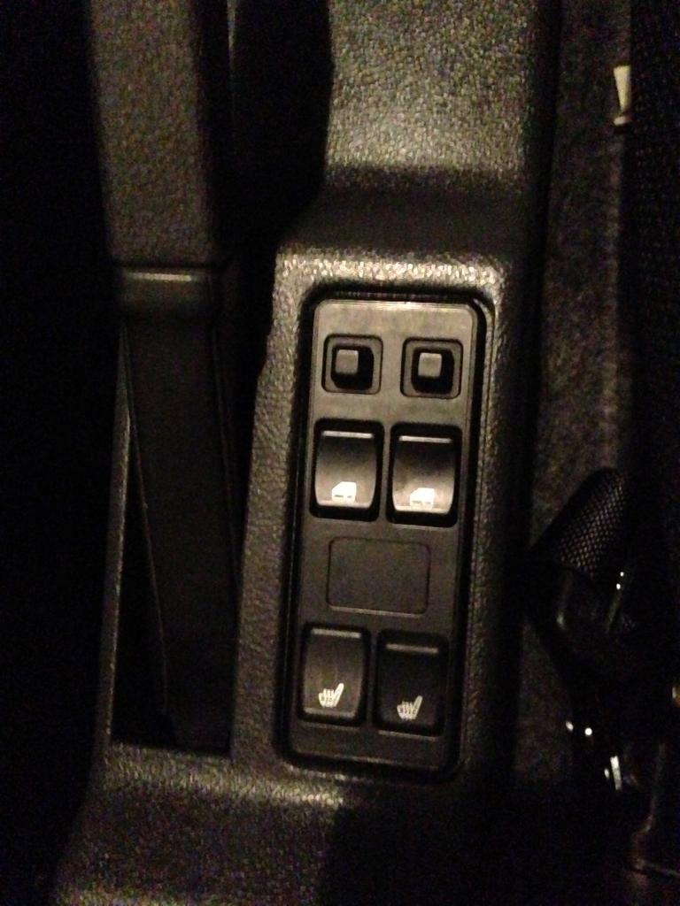

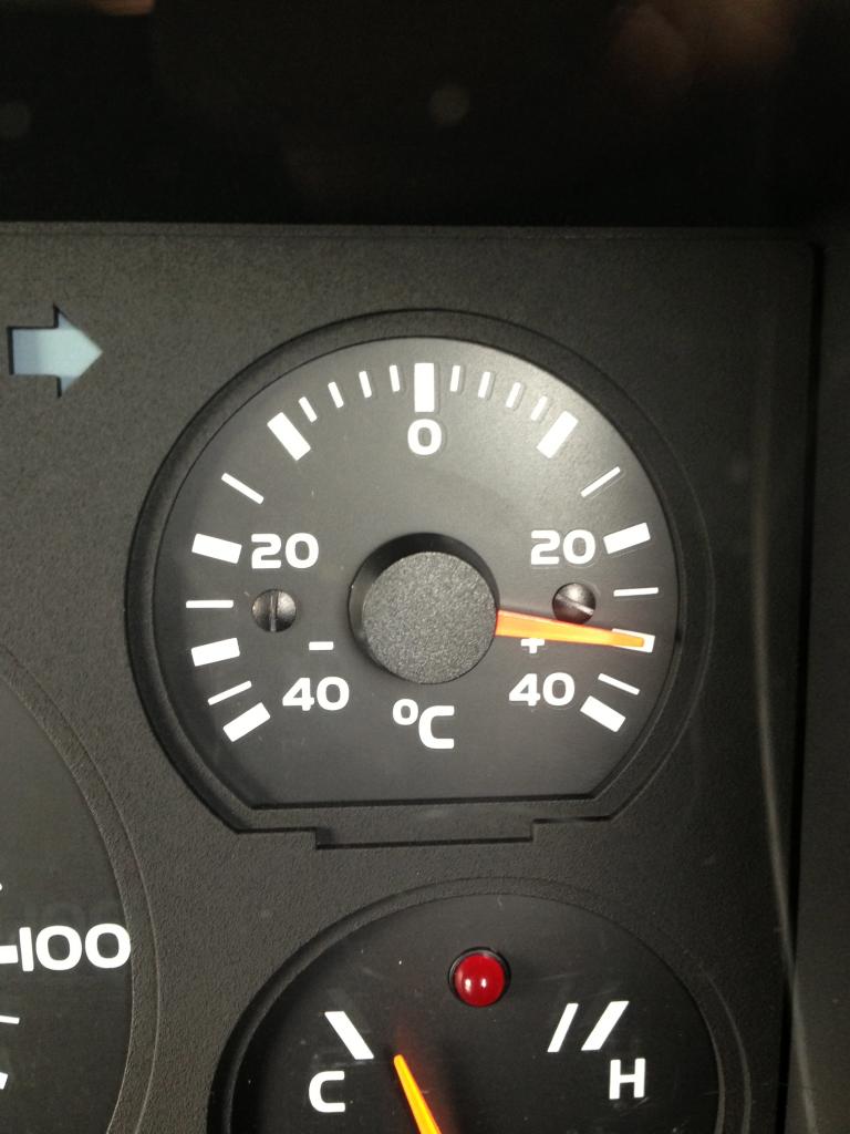

I have also fitted a few electrical upgrades; Electric windows, electric mirrors, central locking with fob, ambient temp gauge, clock etc..
Was able to get the original switches for the windows and the mirrors which just slots in
The ambient temp gauge, just have to fit the probe in the bumper trumpet
And now just a few pics of the car; will get some more pics soon, should also be picking up the centre console gauges.
More to come soon,
Ben…………….
Inside looks well done, not a ridiculous level of stripped but a purposeful car that can be used.
I keep thinking about a flocked dash, but given most of my events are night based it's more just for rally pimpness. Looking at that, I might have too soon!

Thanks, and no this is still my daily so its not majorly stripped :lol: I've always wanted a flocked dash, think they really do make the inside of the car look a thousand times better. Real life it looks a lot better. And yeah being able to feel the fluffy dash it a bonus :wink:

Where did you mount the rearward part of the harnesses to?
Benfraser
Posts: 230
Joined: 01 Feb 2012 06:57 pm
Location: Dartford
Post by Benfraser »
Nimminz wrote:Where did you mount the rearward part of the harnesses to?
Eye bolt in the original seat belt holes in the floor wherethe back seatbelts would be. Then the luke harnesses clip on and off the eyebolt
