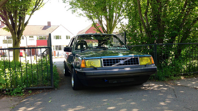

jon-ovlov wrote:Looking goooooood! Always liked the yellow headlights on 300s. Not sure I've got the guts to do mine though. I do have a lot of yellow tint left though, and spare glass . . . .
Thanks I love the look of the yellow. Think you should, can always rip it off ;)

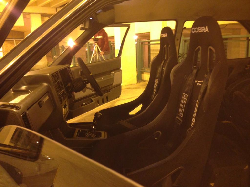

Haven't posted in a while so here it goes… SInce last time i haven't done loads to the car just a few things and I've put the bucket seats in etc.
I just bolted them to the original floor holes using the cobra side mounts and the seat was in the same position as the original one. Just waiting on the harnesses to turn up and it should be looking good inside.

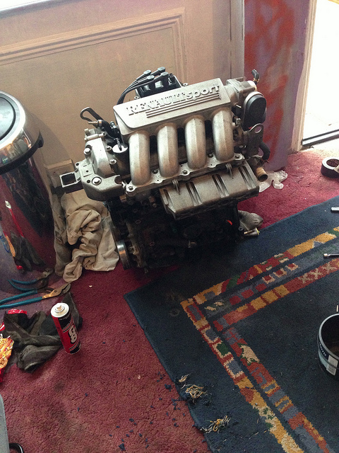

Ohh and i also picked up a cheap clio 172 engine that i was going to attempt to fit but have now changed my mind as they're too much hassle and I'm going to pick up a f7p in a week or so and then I'm going to be starting that which should be eventful! Heres the f4 engine which is also for sale if anyone wants it!
Ben…...

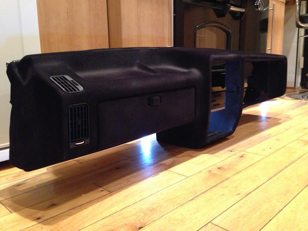

Update… Just some pictures of some things since last time.
Harnesses
Bought a flocked dash and got fitted it, really does change the entire look of the inside…
More to follow!…..

Posted: 05 Oct 2013 05:03 pm
by Nimminz
Where did you mount the rearward part of the harnesses to?
Posted: 06 Oct 2013 10:57 am
by Benfraser
Nimminz wrote:Where did you mount the rearward part of the harnesses to?
Eye bolt in the original seat belt holes in the floor wherethe back seatbelts would be. Then the luke harnesses clip on and off the eyebolt
Ben.......
