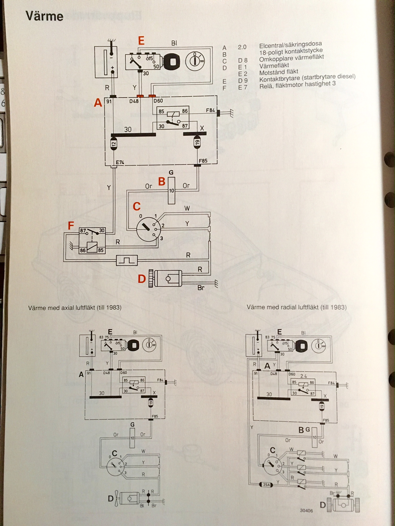

Thanks! I have loads of swedish green books and I found this in one of them
No idea of the schematic on top of the page, maybe it's for later cars like mine (1988)?
On the bottom left it says the schematic is for axial fans up to 1983
On the bottom right, radial fans up to 1983
