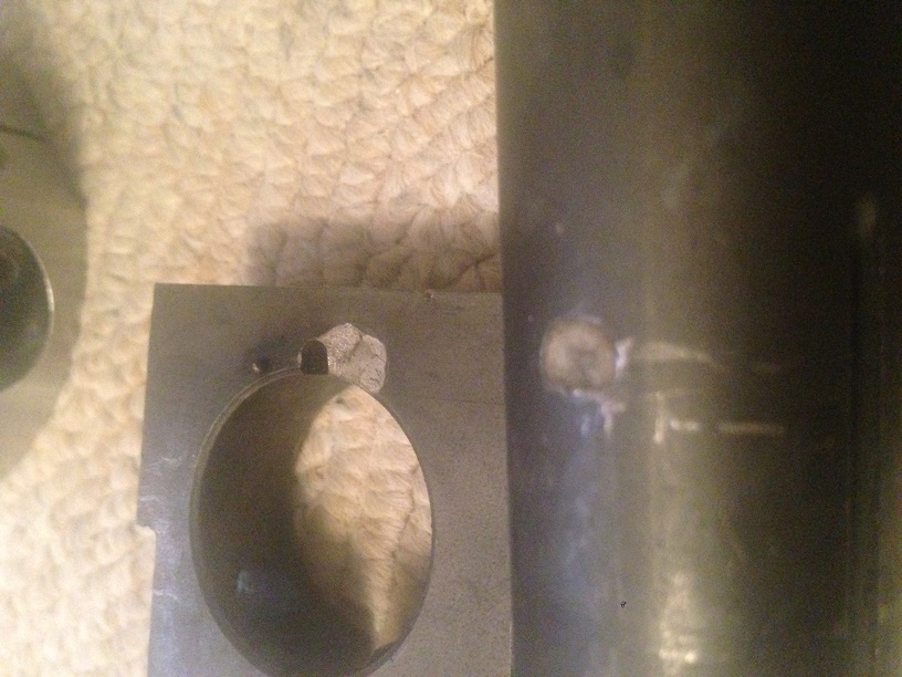

The welding point of one of the original part’s clamps has broken, taking a chunk of cast iron with it:
This won’t happen with the dumbbell…

I did think that normal steel was stronger than stainless, stainless is brittle, but the oversize may compensate, and the bigger bolts less critical on torque. We need an aftermarket part anyhow. I do wonder why Volvo didn't use a sleeve with maybe a locating bolt. Works for the clutch and diff!
The original clamp is certainly tightly engineered howver I believe it works when used as the designer intended with new bolts and an accurate torque wrench, up to around 250bhp. The weld is just to position the clamp, I presume it broke when the bolts failed.
