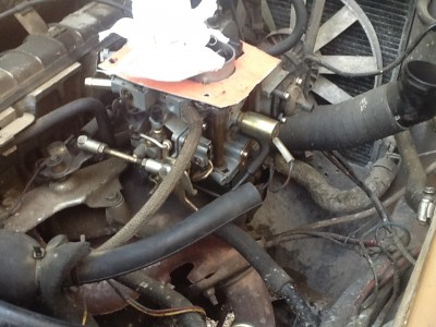

Busicrx
Posts: 41
Joined: 24 Feb 2013 12:25 am
Re: 340 1.7 carb dont work!
Post by Busicrx »
Mountingggg
Busicrx
Posts: 41
Post by Busicrx »
Yyyeeaaah!! All mounted!.. How many turns to adjust the "CO" screw in a aprox. "standart" position, ahh i have a k&n replacement filter.
