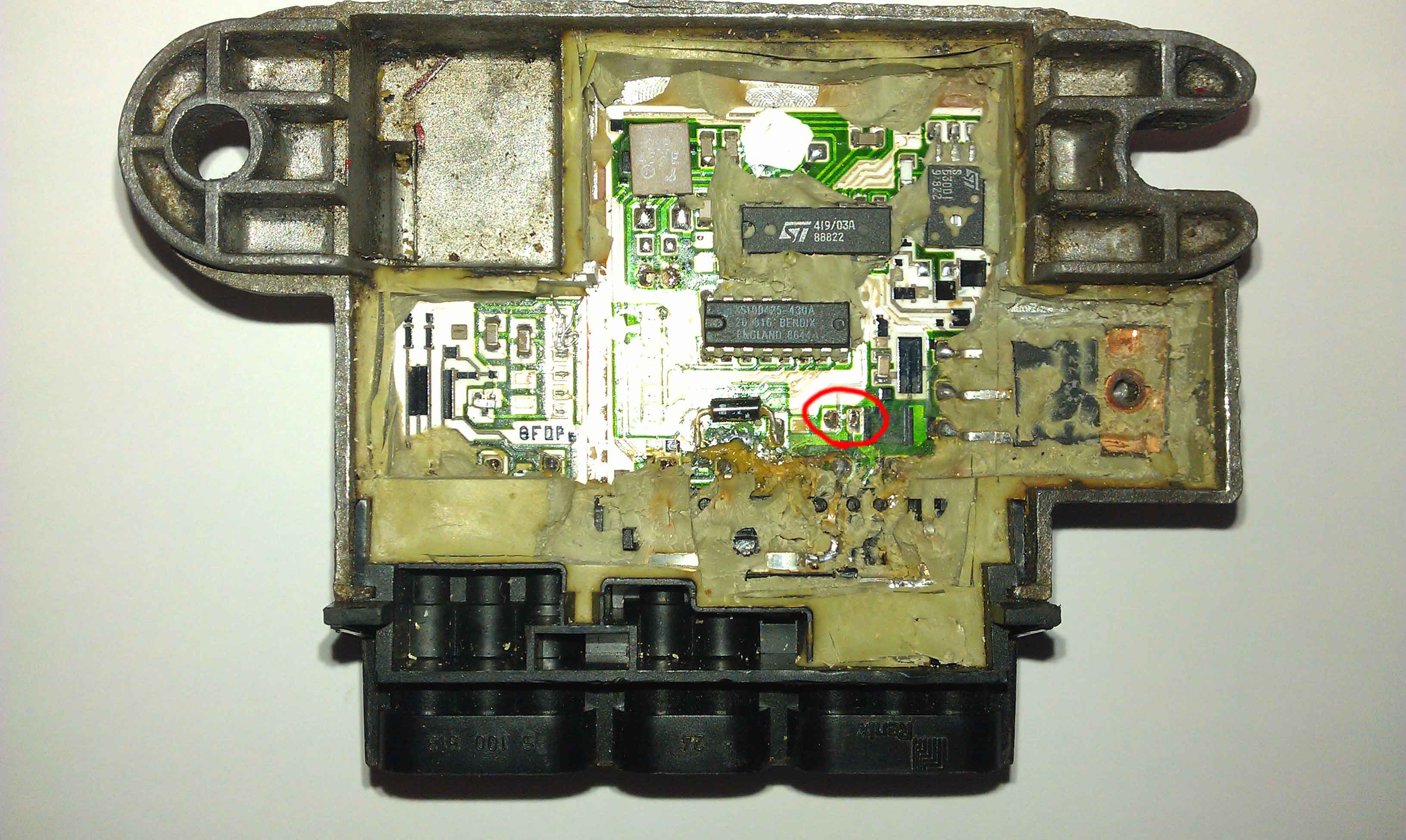

To remove the resin I used a cutter.
The first photo is of a Renix I removed all resin to understand how the circuit is done.

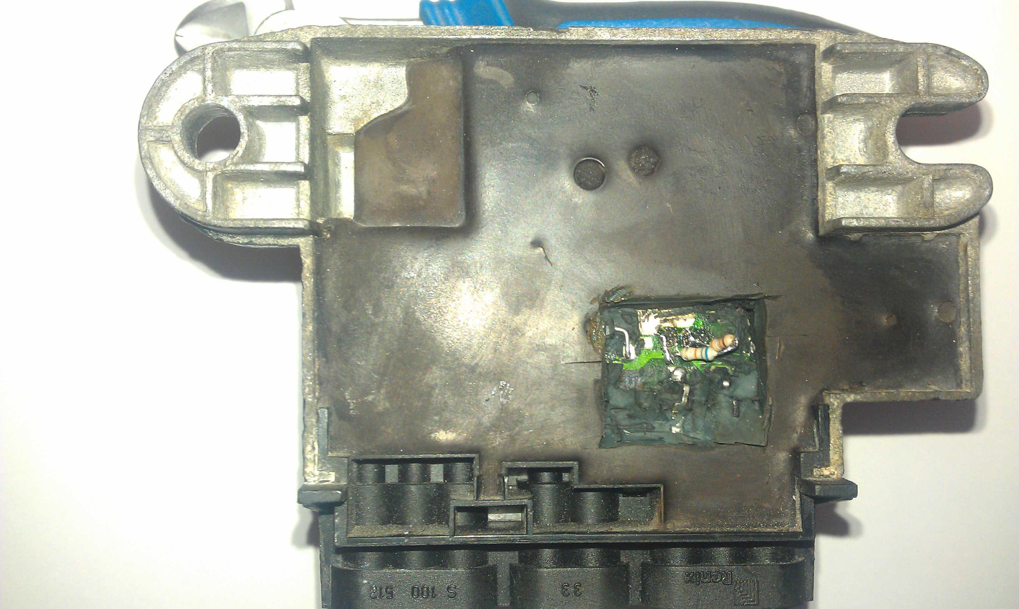

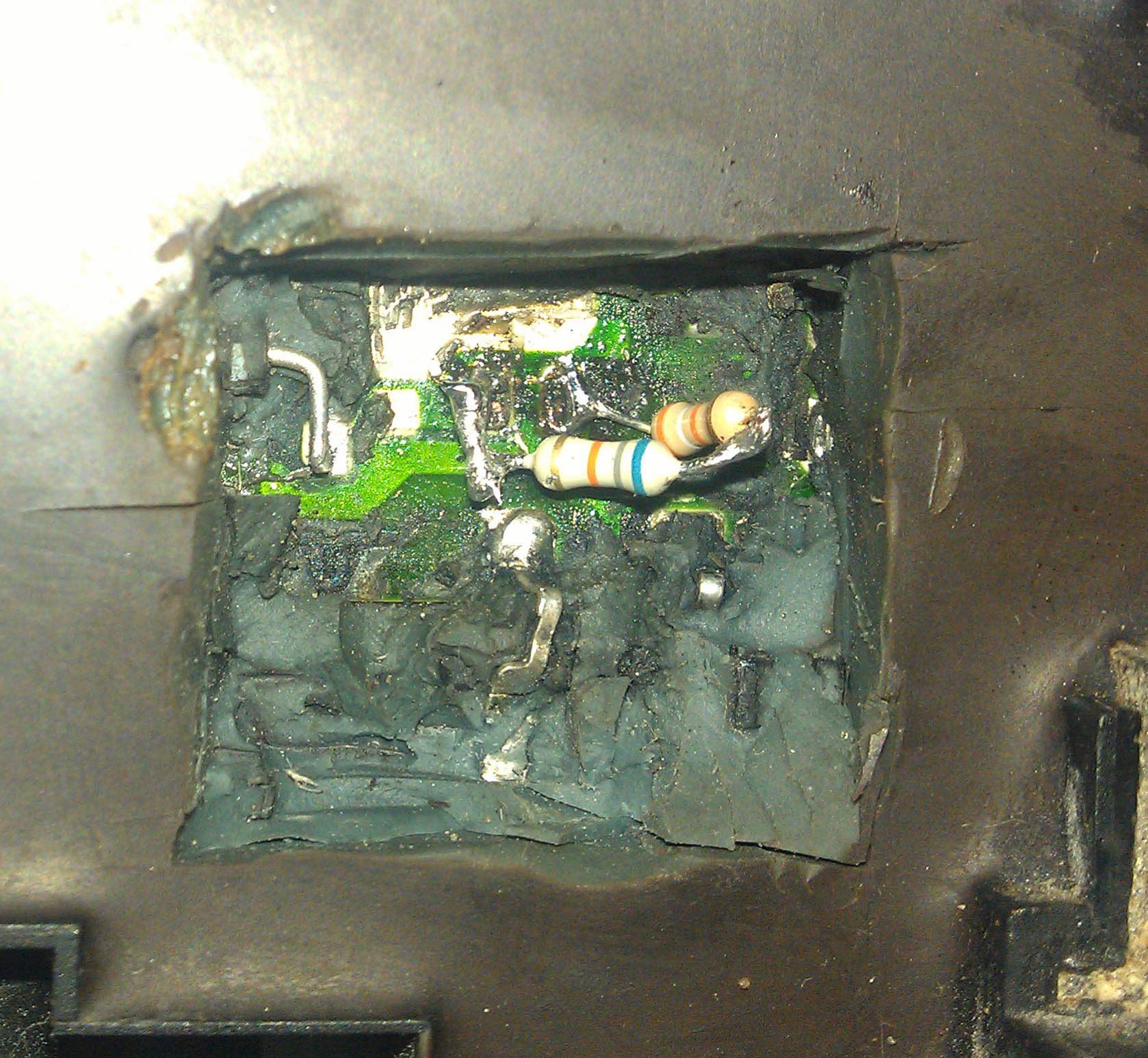

the second and third pictures are of another Renix repaired with a resistor of 1 watt and 100kohm.
