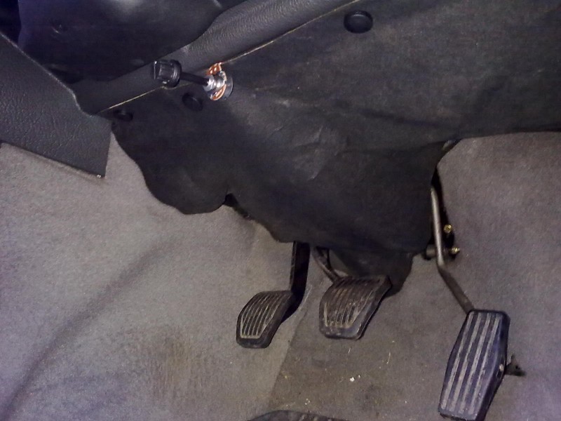

A bit more progress...
... to keep Honey smiling. Actually, I had a bit more work than expected whilst fitting the column switch mounting back correctly. I had to use a plastic spacer (chopped-off bit of cable-tie) of the right width to get spacings right for the horn switch mechanism (brushes and slip rings) to fit together correctly without excessive friction and/or to work at all!

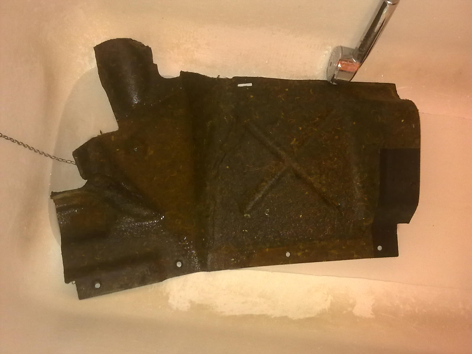

A bit of bathwater being used to re-shape the underdash trim panel...
... hopefully to get a good-enough fit.

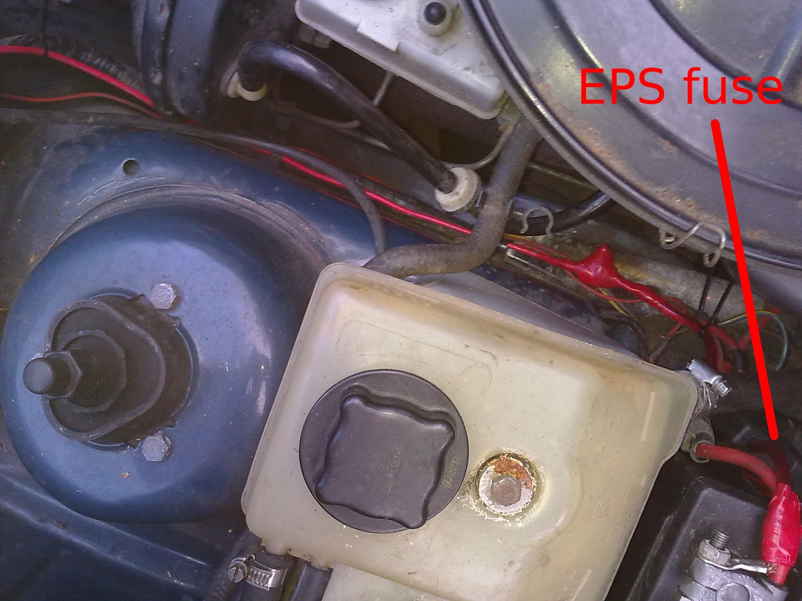

Post by bogbasic »
I have indicated how the wiring goes from the battery via a fuse, as shown lower down.
All else seems to be fine and the trim parts have been refitted but I must remember to refit the clip to the brake servo vacuum hose.
The setup still seems to work fine so attention will turn towards the rear, nearside spring which seems a bit saggy, as well as the front seat belts which don't retract very well.
